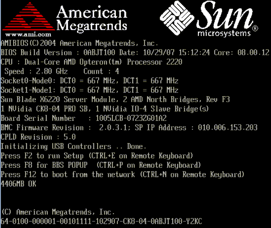

      The BIOS screen appears. An example is shown below (your server’s BIOS screen might look different).
      image:Graphic showing boot messages screen.
      Tip - The next events occur very quickly; therefore, focused attention is needed for the following steps. Watch carefully for these messages, as they appear on the screen for a brief time. You might want to enlarge the size of your screen to eliminate scroll bars.
  2. As the system boots, do one of the following to start a network boot:
    • When prompted, press F12 to boot from the first network boot device found.
    • When prompted, press F8 to display the boot menu and specify the network boot device.
      Tip - On a Sun Blade server module, you can determine the PXE interface boot device by (1) matching the PXE:Slot# (listed on the Please Select Boot Device menu) with the physical NEM or EM slot number label on the chassis, and (2) matching the F# (listed on the Please Select Boot Device menu) with the physical NIC port number label on the NEM (ports 0.0 to 9.0 and 0.1 to 9.1) or EM (ports 0 or port 1).
