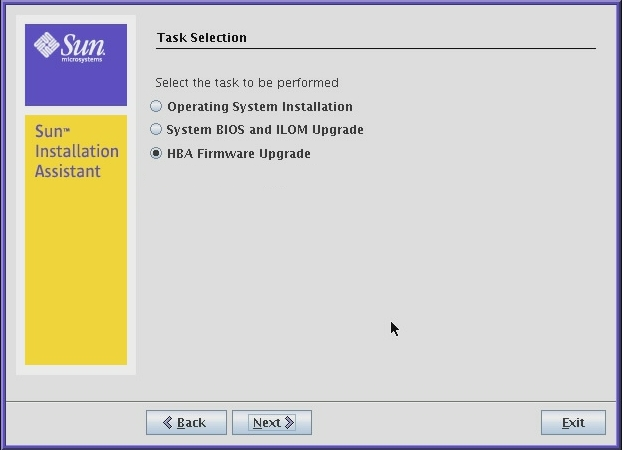

  1. You should have already started SIA and prepared it for tasks as described in Starting SIA and Preparing for Deployment or Recovery Tasks and the Task Selection dialog should be displayed.
    Note - The instructions below assume local CD/DVD drive access. Be sure to modify the instructions accordingly if you are using a local USB flash drive prepared with SIA software, or if you are running SIA from a remote console (or KVMS) with CD-ROM redirection.
  2. Select the HBA Firmware Upgrade task, and then click Next.
    image:Graphic showing HBA Firmware Upgrade task selection.
