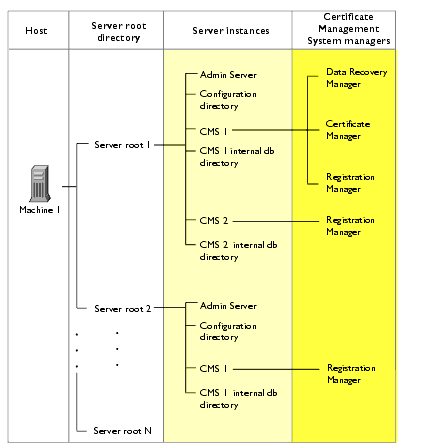

Server Groups and CMS Instances
As described in Managing Servers with Netscape Console, Netscape servers installed in a single server root directory are called a server group and are managed by a single instance of Netscape Administration Server. As shown in Figure 4-1, a CMS instance in a server group can contain a single subsystem of any kind, or either of the following combinations:
  • One Certificate Manager and one Data Recovery Manager
  • One Registration Manager and one Data Recovery Manager
Other combinations are not permitted.
A Certificate Manager and a Registration Manager or Online Certificate Status Manager are always permitted in separate instances, whether the instances are in the same server group, in separate server groups on the same machine, or in separate server groups on separate machines.

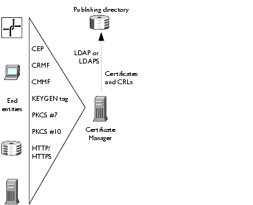

Single Certificate Manager
Some deployments may require only a single Certificate Manager that handles all end-entity interactions and provides no key archival and recovery capabilities. This Certificate Manager can use a signing certificate issued by a public certificate authority or its own self-signed CA signing certificate to sign all the certificates it issues.
Figure 4-1 shows the relationships among a single Certificate Manager, end entities, and a publishing directory. The Certificate Manager can publish both end-entity certificates and CRLs to a directory.
Figure 4-1    Single root Certificate Manager
The arrangement shown in Figure 4-1 is equivalent to the capabilities provided by Netscape Certificate Server 1.x—with the addition of new Certificate Management System features such as Digital Signature Algorithm (DSA) signing, support for PKCS #11, and support for a wider variety of end-entity protocols.

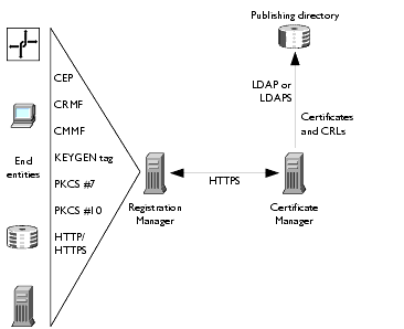

Certificate Manager and Registration Manager
Many organizations need to separate the role of the Registration Manager from the role of the Certificate Manager. This separation can be useful, for example, if different groups of end entities are subject to different authentication policies or work in different geographic locations.
Each group of end entities interacts with a designated Registration Manager that processes requests from end entities and sends them to a Certificate Manager. The Certificate Manager can accept requests from both end entities and Registration Managers. For example, end entities at the home office might deal directly with the Certificate Manager, while end entities at a branch office might deal with their own Registration Manager. Alternatively, the Certificate Manager might be configured to accept requests only from Registration Managers, thus shielding the CA from end entities.
As stated earlier, a single CMS instance cannot contain both a Certificate Manager and a Registration Manager. A Certificate Manager that needs to interact with end entities other than Registration Managers provides all Registration Manager capabilities itself.
A Registration Manager can be installed in one CMS instance and its related Certificate Manager in another CMS instance. The separate instances can be located in the same server group, in different server groups on the same machine, or on different machines.
Figure 4-2 shows a Registration Manager and its Certificate Manager in separate instances on separate machines. All communication between the Certificate Manager and the Registration Manager takes place over HTTPS.
Figure 4-2    Certificate Manager and Registration Manager in different instances
In many organizations, it may be desirable to deploy multiple Registration Managers that all communicate with a single Certificate Manager. Each separate Registration Manager, for example, might handle all end-entity interactions in a particular geographic area or within an organizational group.

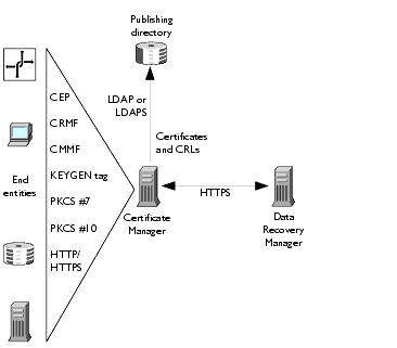

Certificate Manager and Data Recovery Manager
If an organization requires key archival and recovery capabilities—for example, if encrypted mail is widely used and the organization risks data loss if it is unable to recover encryption keys—it can install a Data Recovery Manager. This can be done without regard for the presence or absence of a separate Registration Manager.
For example, to add key storage and recovery to the scenario sketched in Figure 4-2, a Data Recovery Manager can be installed either in the same CMS instance in which the Certificate Manager is installed or in a different CMS instance (which can be located in the same server group on the same machine, in a different server group on the same machine, or on a different machine.)
Figure 4-3 shows a Data Recovery Manager in a separate CMS instance. In this case all communication between the Certificate Manager and the Data Recovery Manager takes place over HTTPS. If the Data Recovery Manager and the Certificate Manager are part of the same CMS instance, all communication takes place internally and the two subsystems do not require separate host names or additional configurations.
Figure 4-3    Certificate Manager and Data Recovery Manager in different instances
The Data Recovery Manager is intended for archival and recovery of private encryption keys only. Therefore end entities must be using either a browser that supports dual-key generation or a browser that is using Netscape Personal Security Manager, which supports dual keys.
The decision to keep the Data Recovery Manager in the same instance as the Certificate Manager or in a different instance (most likely on a different machine) depends on many factors. These include firewall considerations, the physical security required for each subsystem, and the physical location of the Certificate Manager agent, Data Recovery Manager agent, and other persons responsible for administering the Certificate Manager and recovering keys.
Like a Certificate Manager, a Data Recovery Manager has special physical security requirements, since a compromised Data Recovery Manager would have devastating security consequences for your entire PKI. You may therefore want to keep the Data Recovery Manager in a special locked room or building, a choice that can affect your deployment strategy.

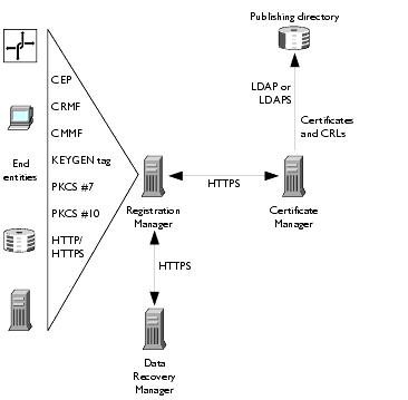

Certificate Manager, Data Recovery Manager, and Registration Manager
The three CMS subsystems can be deployed in many different relationships. Figure 4-4 illustrates some of the issues involved in deploying all three subsystems by showing the relationships among a single Certificate Manager, a single Registration Manager, and a single Data Recovery Manager, each installed in a different CMS instance on a different machine.
The Registration Manager handles all end-entity interactions and communicates with the Certificate Manager and the Data Recovery Manager over HTTPS. The Registration Manager is configured to request the end entity's private encryption key (in encrypted form) and send it to the Data Recovery Manager during the enrollment process. Before the Registration Manager sends the certificate request to the Certificate Manager for processing, the Registration Manager must receive verification from the Data Recovery Manager that the private key has been received and stored and that it corresponds to the end entity's public key.
Only the Certificate Manager can be configured to enable or disable LDAP publishing or to publish to separate directories. The Certificate Manager also has the complete record of issued certificates, so that it can perform the publishing tasks, as shown in the figure.
Many other combinations are possible. For example, the Data Recovery Manager and the Certificate Manager might be in the same instance; there might be multiple Registration Managers in different instances, all dealing with the same Data Recovery Manager and Certificate Manager; or the Certificate Manager might also handle some end-entity interactions. It's also possible to set up both Certificate Managers and Registration Managers such that each has a hierarchy of subordinate managers.
Figure 4-4    Certificate Manager, Registration Manager, and Data Recovery Manager in separate instances
Note The current design of Certificate Management System assumes that most deployments will rely on a single Data Recovery Manager (associated with either a Registration Manager or a Certificate Manager). However, it is also possible to write custom policies that support multiple Data Recovery Managers. This might be useful, for example, for subordinate CAs that issue certificates for completely independent organizations.
You can choose to install either a Certificate Manager and Data Recovery Manager or a Registration Manager and Data Recovery Manager in a single instance. There is not need to install a Certificate Manager and Registration Manager in the same instance; instead, a single Certificate Manager can be configured to perform all Registration Manager functions.
When subsystems are installed in the same instance, the connections between them are internal. Both subsystems must share the same host name, and the overall number of SSL server certificates can be reduced (see Subsystem Certificate Decisions).

Deployment Strategy and Port Assignments
Before you install any CMS instance, you should review the decisions described in this chapter and work out the relationships between the Certificate Managers, Data Recovery Managers, Registration Managers, and Online Certificate Status Managers you want to deploy for your organization. Once you have decided which subsystems to install and where, fill out a copy of the worksheet provided in Chapter 5 "Installation Worksheet" for each separate installation.
You can create multiple instances of Certificate Management System in a single server root directory, each containing either one or two CMS managers. If you want to install CMS managers on different hosts, you must run the entire installation on each host, specifying the services for each instance of Certificate Management System. You can also perform additional complete installations on the same host in a different server root directory.
Figure 4-5 shows an example of how several CMS instances can be installed on a single host machine. (Note that on Windows NT, you can install a single server root only; multiple server roots are not permitted.)
Figure 4-5    Deploying servers on a single host
Each server root directory shown in Figure 4-5 has its own Administration Server and Netscape Console and access to a configuration directory. Each CMS instance has a corresponding instance of Directory Server that functions as the internal database for that CMS instance. Each server root directory can have one or more instances of Certificate Management System, each with its own set of one or two subsystems and its own corresponding internal database.
Figure 3-1 in Chapter 2 illustrates the ports used by a single CMS instance. You can also install multiple instances on a single machine, either in the same server root or as completely separate installations in separate server roots.
When you install additional CMS instances on a machine with a single IP address, you are required to specify a different set of ports for each CMS instance to listen on. That is, each CMS instance will require at least four unique ports:
  • Internal database port for communication with internal database
  • SSL administration port for communication with Netscape Console
  • SSL agent port for communication with designated agents
  • At least one of these ports:
    • SSL user port for communication with end entities
    • Non-SSL user port for communication with end entities
The ports shown above are required for each CMS instance. Each server root needs two additional unique ports: one for the Directory Server being used as the configuration directory and one for the Administration Server.
When you install additional CMS instances on a machine that has been set up with more than one IP address, you can configure each instance to listen to a specific IP address. If each instance has a different IP address, you can use the same port numbers for additional CMS instances installed on the same machine—that is, you can use one set of four or five ports for all the instances.
For more information about installing multiple CMS instances, see Chapter 7 "Installing and Uninstalling CMS Instances."
