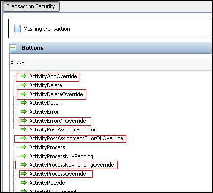

    Security group Override buttons for the Allow and UpdateDate elements determine which user security groups are exempt from processing the validation. Override buttons are available for Add, Delete, Process, Reverse, and Update. The system checks permissions for the current user’s security group and the list. If the group has the proper override permission checked, then the timing validation is not executed.
    Override Buttons in Transaction Security
