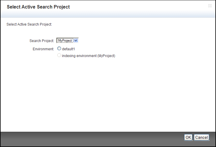

To view customization data in the context of a particular search project with which it is associated, use the Select link to choose a project.
Some Workbench tools, such as Dictionary Inspection, require an active project to work on. You can change the active project at any time.
