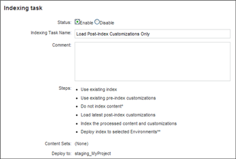

  2. Click Save as Auto-Indexing Rule. The page switches to the Automatic Indexing Rules tab. An example follows.
  3. Select Enable or Disable.
  4. Provide an Indexing Task Name (required).
  5. Add a descriptive comment (optional).

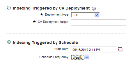

  6. Select an indexing trigger.
    • CA Deployment—The indexing process runs every time the specified target receives an ATG Content Administration deployment. The target name you provide must be exactly the same as it appears in ATG Content Administration.

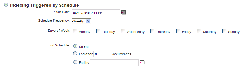

    • Schedule—Set up a schedule on which the indexing rule should run.
    • Request—Use this setting for integration with Oracle ATG Web Knowledge Manager.
