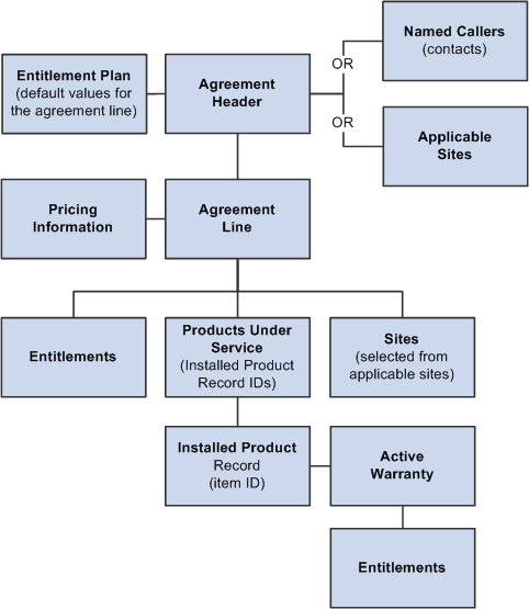

This diagram shows the data model for agreements and shows the relationship between agreements and warranties:
Agreement data model

Defining AgreementsThis section provides an overview of agreement definitions and discusses how to:
Define agreement header information.
Specify people or sites that are entitled to service or support.
Specify line defaults.
Define detailed agreement line information.
Define billing information.
Understanding Agreement Definitions
When you create a case or service order for a customer and click the Select Agreement or Warranty button, the CRM system searches for agreement lines or warranties that cover the case or service order and displays the associated entitlements.
The CRM system uses the values that you have entered in the fields for product ID, serial number, and either site or SIN to search for agreement line and warranty matches for service orders.
For cases, the CRM system uses the same fields, as well as those for contact or PIN. For both cases and service orders, the entitlement match page also displays any transaction price information that is defined under the terms of the agreement.
Internal agreements define the levels of service that are available to Help Desk and HR Help Desk cases. These cases use the additional information of organizational relationship, as defined by the person type, and worker status to locate and display the levels of service that are defined on the agreement.
External - No Pricing agreements are similar to External agreements, except they do not display pricing-related fields, only prepaid amounts. Using External - No Pricing agreements enables you to specify how many free prepaid cases or services, or hours of support, a customer is entitled to on an agreement. For PeopleSoft Support, you can specify prepaid at the agreement header level or in the product grid on the agreement line. For FieldService, you can specify prepaid on the agreement header, agreement line for service, or on the product grid on the agreement line.

Defining Detailed Agreement Line Information
Access the Agreement Line page (Customer Contracts CRM, Agreements, Agreements, Agreement Line).
Note. If you are creating an agreement for PeopleSoft HelpDesk and selected Internal as the agreement category when you added the agreement, the system does not display the Sites and Price Information sub pages and links. If you selected External - No Pricing as the agreement category, the system does not display the Price Information sub page.
Agreement Line: View Line Summary
If an agreement has multiple agreement lines, they are listed in the Agreement Lines summary grid (available when you click the View Line Summary link) with basic information such as agreement line and service descriptions, product name, and product ID number. Click the agreement line number link to access the Agreement Line Details group box, where you can edit and view the corresponding line in detail.
If there is only one line in the agreement, the CRM system displays the Agreement Line Details group box together with pricing, site, entitlements, and product information.
When you click the Line Details link at the top of the page, the CRM system displays information for the selected agreement line in group boxes such as Retrieve Base Line Price, Calculate Final Line Price, Entitlements and so on. To minimize the need for scrolling, you can click the Sites, Entitlements, Installed Products, or Price Information links to view corresponding information selectively.
