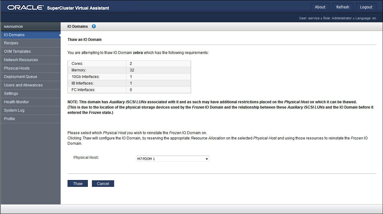

    The next screen enables you to choose a physical host for this I/O Domain. If you pinned an I/O domain to a host, the domain can only be thawed on that specific host. For more information, see Freeze a Domain.
    If the assistant detects that any auxiliary ISCSI LUNs are associated with the I/O Domain, the assistant includes that information in the screen, as shown below:
    image:A screen shot showing the confirmation page with information about                             auxiliary iSCSI LUNs.

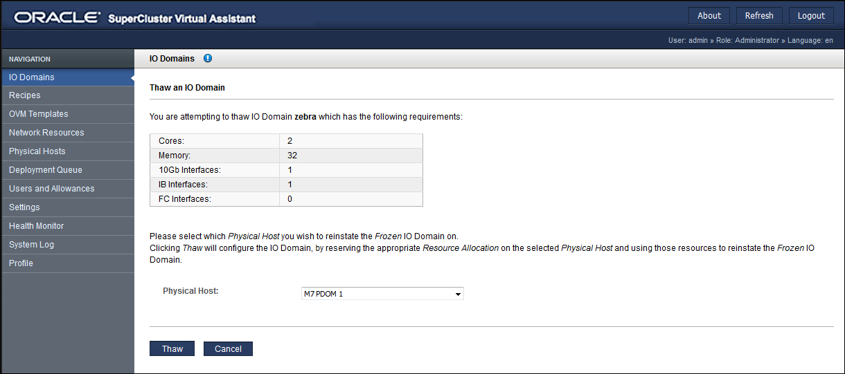

    This example shows the screen that is displayed when there are no auxiliary iSCSI LUNs associated with the I/O Domain.

  5. Select a physical host from the drop-down menu.
    Not all I/O domains can be thawed on all physical hosts for these reasons:
    • If you pinned an I/O Domain to a physical host, that domain can only be thawed on that specific physical host. For more information, see Freeze a Domain.
    • You can only thaw an I/O Domain on a physical host that has sufficient available resources to accommodate the frozen I/O Domain.
    • Some I/O Domains have auxiliary LUNs associated with them (for example, for zone file systems). These I/O Domains can only be thawed on physical hosts that have access to all auxiliary LUNS.

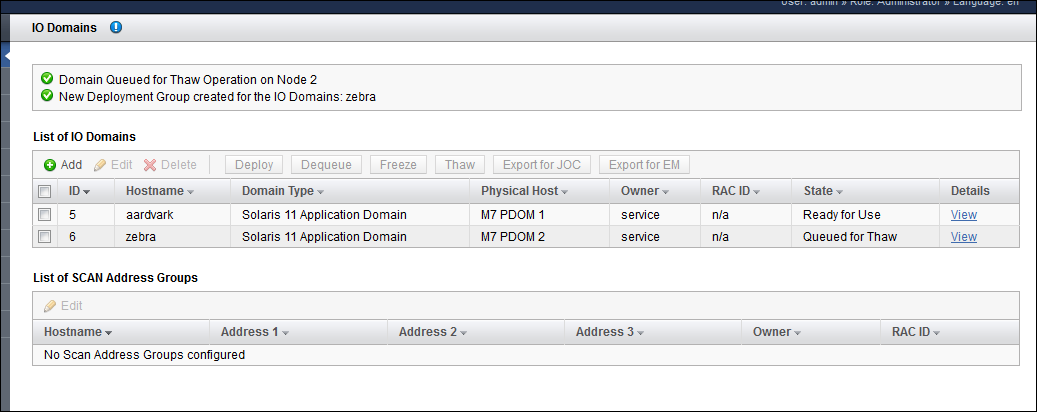

    This example shows the state of the I/O Domain during the thaw process.
    image:A screen shot showing the I/O Domain page when a thaw operation is                             being performed.

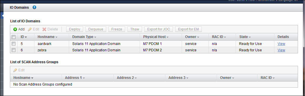

    This example shows the state of the I/O Domain when the thaw is complete.
    image:A screen shot showing the I/O Domain page when a thaw operation is                             complete.
