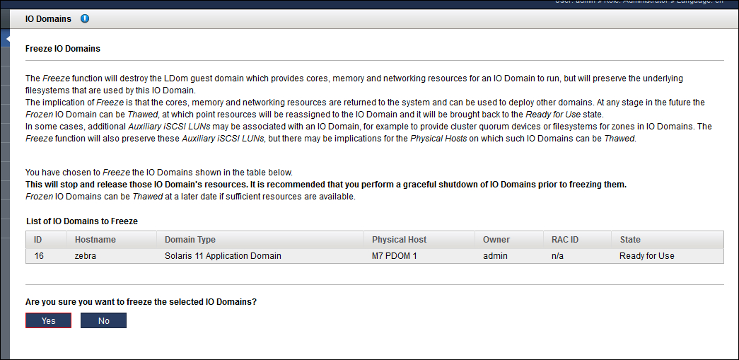

  6. Click Yes to freeze the domain.
    This example shows the confirmation screen with the tool tip expanded.
    image:A screen shot showing the confirmation screen with the tool tip                             displayed.

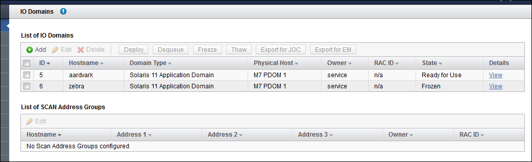

  7. Click Yes to confirm the freeze operation.
    The process takes a few minutes to complete. After the process completes, Frozen is displayed in the State column.
    Tip  -  Click Refresh to ensure that the page reflects the most current state.
    image:A screen shot showing a frozen I/O Domain.
