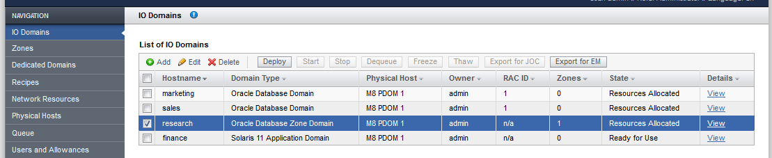

    • If you are configuring a Database Domain:
      1. In the navigation panel, select I/O Domain.
      2. Select the check box next to each Database Domain that you want to configure.
        image:A screen shot showing the I/O Domains page.
      3. Go to Step 4.

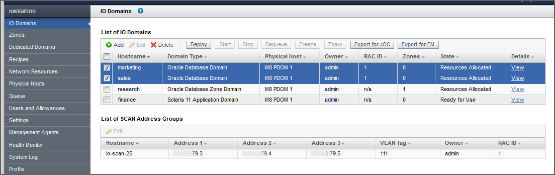

    • If you are configuring a Database Zone:
      1. In the navigation panel, select Zones.
      2. Select the check box next to each Database Zone that you want to configure.
        If you have multiple database zones that are part of a single RAC, select those zones as shown below.
        image:A screen shot showing the Zones page.
      3. Go to Step 4.
