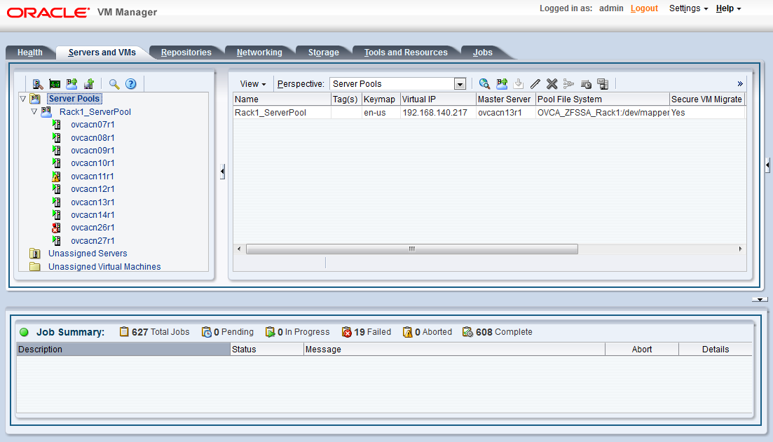

The Servers and VMs tab is used to create and manage your virtual machines. By default, compute nodes are listed as belonging to a single server pool called Rack1_ServerPool. The configuration of this server pool must not be altered. There is no need to discover servers, as compute nodes are automatically provisioned and discovered within an Oracle Virtual Compute Appliance. Editing the configuration of the server pool, servers, affinity groups and processor compatibility groups is not supported. The primary purpose of this tab within the Oracle Virtual Compute Appliance context is to create and manage your virtual machines.
