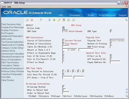

When you set up a simple DBA, you specify the minimum amount of information the system needs to perform the calculation. Typically, you will want to calculate a simple DBA in one of two ways:
When you set up a simple DBA, you can do one of the following:
Specify the actual amount or rate to calculate
Omit the actual amount or rate to calculate
If you omit the actual flat dollar amount or the percentage rate information during setup, you can enter it when you assign the DBA at the group, employee, or timecard level.
To designate whether this is a deduction, benefit, or an accrual complete the following field:
DBA Type
Complete the following fields:
DBA Code
Source of Calculation
Method of Calculation
If you want the same amount or rate to apply to all employees assigned the DBA, complete the following field:
Amount or Rate 1

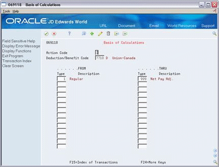

On Basis of Calculations, if you want to include all pay types (1 - 999) for calculating the DBA, exit the Basis of Calculation screen without making any entries.
On Basis of Calculations, if you want to limit the PDBAs, complete the following fields with the range of pay types you want included in the calculation and press Enter:
From PDBA Type
Thru PDBA Type
On DBA Setup, locate the DBA.
Review the values supplied by the system for the following fields:
Effect on Disposable Wage
Calculate if No Gross
Effect on General Ledger
A/P Voucher
Pay Period to Calculate
Calculate Once Per Period
Arrearage Method
When to Adjust Deductions
If you want DBA information to appear on the employees' pay stubs, verify the following fields:
Method of Printing
Calculate in Pre-Payroll
| Field | Explanation |
| DBA Type | A code used to distinguish between the following types of payroll entries:
P – Time Cards (Earnings) D– Deductions withheld B – Benefit (both cash and non cash) A – Accrual of sick, vacation, compensation, and so forth Note: These codes may only be changed by JD Edwards World. If you enter an * in this field the system displays all four types of PDBAs. |
| DBA Code | A code to define the type of pay, deduction, benefit, or accrual.
Pay types are numbered from 1 to 999. Deductions and benefits are numbered from 1000 to 9999. Form-specific information The DBA code 9997 is reserved for Overpayment. Do not change this deduction code. Sick and vacation accruals must have a specific numbering order. You must assign a higher number for the time available code when you are also assigning a time accrued code. For example, if vacation accrued is 8001, vacation available must be 8002 or greater. |
| Source of Calculation | A user defined code (07/DB) that defines what the deduction, benefit, or accrual (DBA) is based on. A numeric code indicates that the DBA is based on a disposable net wage calculation. When the system calculates the gross amount for a disposable net wage, it does not use the basis of calculation. The gross amount includes all earnings that have a +/+ effect on gross/net.
For Current Period, use code G. For wage attachments use one of the following codes: 1 - 7 – Garnishment Tax levy Wage assignment (child support and maintenance) R – Loan Interest 0 – Fees |
| Method of Calculation | A user defined code 07/DM that indicates which method the system uses to calculate the deduction, benefit, or accrual.
The method values are pre-set by JD Edwards World. If you use methods 0 - 6, 8, 9, or G, you must also enter a value in the Table Code field. For wage attachments, use one of the following methods: C – Wage assignment (child support and maintenance) G – Garnishment K – Loan L – Tax levy A – Fees % – Interest For Spousal Life Insurance Premiums, use one of the following methods (07/DS): 3 – Calculates the spouse's age as of the last day of the current taxable year. 9 – Uses the Age field value entered on the Dependent/Beneficiary Entry screen. Z – Calculates the spouse's age by the actual Date of Birth (DOB). |
| Method of Printing | Identifies whether the item is to be printed on the pay stub and whether the item is to be printed on a separate cheque from other payroll items. Valid codes are:
Pay Types/Payroll Taxes: Y – Print on pay stub (default) S – Print separate check (one item per check) C – Print separate check (C types combined) N – Do not print on pay stub Deduction/Benefit/Accrual Types: Y – Print as total deductions (default) S – Print separate check (one item per check) C – Print separate check (include detail) N – Do not print on pay stub I – Print individual transactions T – Print by DBA Print Group The separate cheque feature is not available for any payroll taxes being withheld from the employee's paycheque. |
| Amount or Rate 1 & 2 | The value in this field is either a percentage, a monetary amount, or an hourly rate, depending on where it is used:
1 – For a deduction, benefit, or accrual, the meaning of this field depends on the Method of Calculation. The method determines if the deduction is a flat dollar amount, a percentage, or a multiplication rate. Table method DBAs, depending on which table method they use, can either use this amount in the calculation or ignore it. If there are exceptions to the table calculation, you can override the table code in the detail area, set up a flat dollar DBA amount, or override the amount in One Time Overrides. 2 – For a pay type, amounts entered in this field override the hourly rate. Form-specific information The first amount or rate associated with a deduction, benefit, or accrual. Because many DBA types require multiple tiers, two Amounts (Rates) exist. The system uses Amount (Rate) 1 until the first annual limit is reached. Then the system uses Amount (Rate) 2, beginning with the next time the employee is paid and continuing until the second annual limit is reached. These fields work in conjunction with the annual limit fields. |
| Effect on Disposable Wage | This code designates whether a DBA is subtracted from gross to determine an employee's disposable wages. Valid codes are:
1 – Voluntary. These deductions are subtracted from gross to determine disposable wages for deductions with a Source of Calculation of 1, 5, and 7. 2 – Mandatory. These deductions are subtracted from gross to determine disposable wages for deductions with Source of Calculation of 1, 2, 4, 5, 6, and 7. |
| Effect on GL | A code indicating whether you want journal entries passed from payroll to the general ledger and the method you want to use. Valid codes are:
N – Pass dollars only to the general ledger. M – Do not pass dollars or hours to the general ledger. This code allows an accrual to be tracked in employee payroll history and the dollars to be omitted from the general ledger. Form-specific information When you enter B in the Method of Calculation field to accumulate wages, use the following values to indicate the effect on the general ledger: If your organization uses accrual basis accounting, enter N. If your organization uses cash basis accounting, enter M. |
| Calc in Pre-Payroll (Y,N) | A code specifying whether a benefit or accrual is calculated during pre-payroll processing. Valid codes are:
Y – Yes, calculate during pre-payroll processing. N – No, calculate during the journal entry step of the payroll cycle. In general, all benefits and accruals are calculated during the processing of journal entries because they do not affect the gross-to-net calculation. However, certain benefits, such as group life insurance and the corresponding excess life insurance benefit, must be calculated in pre-payroll because they affect the gross-to-net calculation. If you want the benefit or accrual to print on the employee's pay stub, use Y and complete the Method of Printing field. |
| A/P Voucher (Y,N) | A code used to determine whether the system should generate a voucher for the DBA, tax, or wage attachment during the final update phase of the payroll processing cycle. Valid codes are:
N – No, do not generate a voucher Y – Yes, generate a voucher |
| Pay Period to Calculate | A code designating the pay period in which the system calculates the DBA or auto deposit. Valid codes are:
Y – Take the DBA or auto deposit during the current period. N– Do not take the DBA or auto deposit during the current period. * – Take the DBA or auto deposit only during the first pay period of each month that the employee works based on the ending date of this month's pay period. Blank Continue to look for a code at the lower level. The system searches for DBA or auto deposit rules first at the employee level, then at the group level, and finally at the DBA master level. If the field is blank at all levels, the system does not calculate the DBA or auto deposit in that period. M – Use this value only in the field for a fifth period to calculate the benefit during the special, or manual, timecard post. M applies only to benefits based on gross hours or dollars. An M implies a Yes for a weekly withholding frequency. You should not use this value for any DBA with B in the Method of Calculation field. |
| Arrearage Method | A code indicating how to adjust deductions when the employee is in a negative pay situation. Valid codes are:
P – Do a partial or full deduction as needed. This is the default. F – Do a full reduction or none at all. N – Do not reduce. Q – Same as code P. Place the amount in arrears, but do not apply the limits when collecting the arrearage. R – Same as code P. Place the amount in arrears and apply the limits when collecting the arrearage. G – Same as code F. Place the amount in arrears, but do not apply the limits when collecting the arrearage. H – Same as code F. Place the amount in arrears and apply the limits when collecting the arrearage. |
| Calc Once Per Period (Y,N) | A code that indicates whether the deduction, benefit, or accrual should be calculated only once in a pay period if the employee receives more than one cheque. |
| When to Adjust Ded | A – code that indicates when to adjust (back out) deductions. Valid values are:
0 – Adjust deductions marked with 0 before payroll taxes. 1 – Adjust deductions marked with 0, then those marked with 1 before payroll taxes. 2 – Adjust payroll taxes before the deductions marked with 2. |

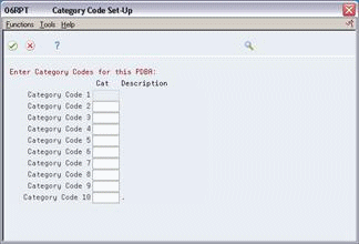

Set up category codes for DBAs

From Pay/Deductions/Benefits Setup (G7742), choose DBA Setup
You set up category codes for DBAs as a way to group together DBAs for reporting purposes. You can use category codes one through ten for these purposes.
To set up category codes for DBAs
On DBA Setup
Complete the applicable steps for setting up a simple DBA.
On Category Codes Setup, complete the following field:
Category (Cat)
| Cat | This is a Payroll system category code for Deductions, Benefits and Accruals. You may define the use and description of this code to fit the needs of your organization. |
From Canadian Payroll Master (G77), enter 29
From Payroll Setup (G774), choose Pay/Deductions/Benefits
You set up a DBA based on another DBA to use a value that has already been calculated (from the based-on DBA) to calculate the DBA you are setting up. For example, you set up an RRSP employer match benefit based on an RRSP deduction that has already been set up to deduct a certain amount from an employee's pay.
If you set up a DBA based on another DBA, both DBAs must be associated, though not necessarily assigned at the same level. For example, if you set up an RRSP plan DBA code containing deduction percentages at the employee level, you must indicate that the DBA is associated with a union or group plan when you are entering additional information. This allows you to set up a DBA code and assign company matching funds for an RRSP plan at the union or group level. When you indicate the union or group plan association in the DBA specifications, the system recognizes that both DBA codes are associated at the union or group level.
If DBAs are based on other DBAs, you must assign numbers to those transactions accordingly. The system calculates DBAs in numeric order, from low to high. For example, if your company matching RRSP benefit is based on the employee deduction, the DBA code for the employee RRSP deduction must be the lower number of the two so that the system calculates it before calculating the matching DBA.
To set up a DBA based on another DBA
On DBA Setup
Complete the steps for setting up a simple DBA.
Use the Add action.
On Basis of Calculations, complete the following fields with the DBA code that the DBA is based on:
From DBA Type
Thru DBA Type
If the DBA entered for the basis of calculation is assigned at the group level and the new DBA is assigned at the employee level, choose the Additional Information function.
On Additional Information, enter Y in the following field:
Include in Union Plan
To verify that you have set up your DBA correctly, you can assign it to an employee and process an interim payment for that employee. The interim payment detail displays the DBA amount and also the basis of calculation. For example, if a deduction is a percentage of an employee's gross pay, the basis of calculation is the gross amount.
On DBA Setup
Follow the steps for setting up a simple deduction, benefit, or accrual.
On DBA Instructions, assign the DBA to an employee.
See Section 35.1, "Setting Up Deductions, Benefits, and Accruals".See Section 35.2, "Setting Up Simple DBAs"
Enter an interim cheque for that employee using the cheque detail to verify the DBA calculations
See Entering Interim Checks in JD Edwards World Canadian Payroll I Guide.
Delete the interim cheque and associated DBAs and timecards.

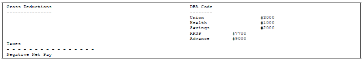

In this example, you want the RRSP adjusted (not deducted) before the Advance, Union dues, and Health. Therefore, assign RRSP a value of 0 in the When to Adjust Deductions field. Assign Advance, Union dues, and Health a value of 1.
The following illustrates the sequence of adjustments the system will use to bring the payment balance to .00:
Company policy might be to deduct the advance from the employee's pay before taxes are deducted. The government will make up any tax inequity with this employee at year end, but the company may not be able to retrieve the advance amount if the company no longer employs the individual. Enter 2 in the When to Adjust Deductions field for the Advance. The sequence of adjustments is as follows:
Figure 35-10 Example: Payroll Calculations to Adjust Negative Pay
This example illustrates how the codes in the When To Adjust and Order to Adjust fields would work for one employee. When you set up your DBAs you must consider how these codes impact all employees using these deductions.

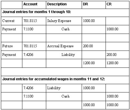

The following examples illustrate the accumulation of wages earned in a 10 month contract that are paid over 12 months. The employee earns $12,000 for the contract. To simplify the illustration, taxes are not included in the examples.
In this example, the employee works for an organization that uses accrual basis accounting. The wages are expensed at the time they are earned. The system passes the amount of the DBA for accumulated wages to the general ledger as a burden expense. The offsetting credit is a liability.
The system enters the $200.00 liability for account 7.4206 in the Payroll Accrual Distribution History table (F0628). When the contract ends, the system continues to generate payments for the amount of accumulated wages stored in the history table for the specified number of pay periods. In this example, after 10 months, the employee has $2000.00 accumulated. The system divides this amount between the monthly pay periods in months 11 and 12. The employee receives a payment up to the pay period amount for these two months.
Figure 35-11 Accrual Basis Accounting Example in the Payroll Accrual Distribution History table

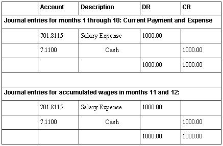

This example assumes that a contract calendar begins on the first day of the first month and ends on the last day of the tenth month. Frequently, a contract calendar covers only some of the days in month, for example month 10 might end on the 15th. In such a situation, the employee's wages for that month would include regular pay for the days covered under the contract and the remainder of the payment would include accumulated wages.
In this example, the employee works for an organization that uses cash basis accounting. The wages are expensed at the time they are paid. The system does not pass the amount of the DBA for accumulated wages to the general ledger.
The system enters the accumulated wages in the Payroll Accrual Distribution History table (F0628) with the associated expense account that would have been used if it had passed to the general ledger. When the contract ends, the system continues the payment and expense distribution for the specified number of pay periods. In this example, after 10 months, the employee has $2000.00 accumulated. The system divides this amount between the monthly pay periods in months 11 and 12. The employee receives a payment up to the pay period amount for these two months.
Figure 35-12 Cash Basis Accounting Example in the Payroll Accrual Distribution History Table
The account number used for salary expense in months 11 and 12 in this example is the same as the account number used for salary expense in months 1 through 10. You can use a different account number for the salary expense for accumulated wages than you use for regular wages.

To set up a DBA for spousal life insurance
From Payroll Setup (G774), choose Pay/Deductions/Benefits From Pay/Deductions/Benefits Setup (G7742), choose DBA Setup
On DBA Setup
Enter D in the following field:
DBA Type
Enter 3, 9, or Z in the following field, as appropriate:
If your organization uses accrual basis accounting, enter N in the following field:
Effect on G/L
If your organization uses cash basis accounting, enter M in the following field:
Effect on G/L
Enter Y or N in the following field:
Pay Period to Calculate 5
Complete the steps for setting up a deduction.
On Basis of Calculation, exclude pay type 996, pay type 997 (to dock pay for excessive leave), and your pay type for bonus pay.

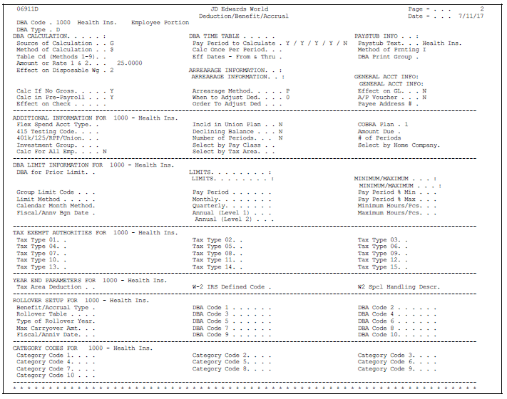

After you have set up all of your DBAs, you can review a detailed listing of them in order by DBA code.
Figure 35-13 Deduction, Benefit, and Accrual report
