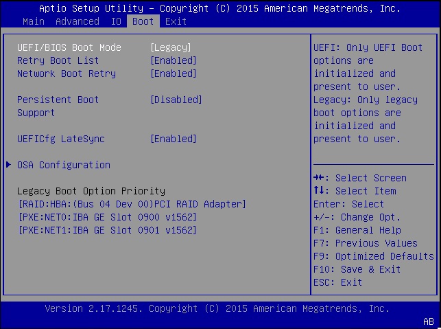

  4. In the BIOS Setup Utility, use the arrow keys to navigate to the Boot menu.
    The Boot menu appears. The UEFI/BIOS Boot Mode field displays the current boot mode.
    image:Legacy BIOS boot mode setting
    Note -  The options in the boot order list differ depending on the storage drive configuration and whether you have enabled the Persistent Boot Support feature. For more information about Persistent Boot Support, refer the Oracle X5 Series Servers Administration Guide at http://www.oracle.com/goto/x86AdminDiag/docs.
