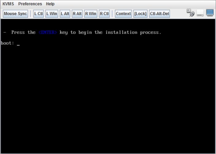

    After a few seconds, the splash screen for Oracle VM Server appears.
    image:Figure showing the splash screen for the Oracle VM Server.
  6. Press Enter to begin the installation.
    If you do not press a key, after one minute, the installer automatically starts. The installer is only available in text mode.
