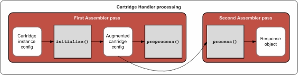

A cartridge handler takes a content item representing the cartridge instance configuration as input and is responsible for returning the response as a content item.
The
CartridgeHandler interface defines three methods:
initialize(),
preprocess(), and
process().
The
initialize() method provides an opportunity for the
cartridge handler to augment the cartridge instance configuration specified in
Experience Manager with configuration from other sources. This can be used to
define default behavior for a cartridge in the case where there is no
Experience Manager configuration, or to override the Experience Manager
configuration for the current query. The
initialize() method should return a content item
containing the complete configuration for the cartridge from all possible
configuration sources. This augmented configuration item can either be the
mutated input content item or a new instance of
ContentItem, and is used as input to both the
preprocess() and
process() methods.
Because the
preprocess() method is called on all cartridges before
process() is called on any cartridges, it provides an
opportunity to coordinate processing between cartridges. Many of the core
cartridges make use of this mechanism in order to consoldiate queries to
an MDEX Engine among several cartridges during the course of a single assembly
cycle.
The
process() method is responsible for returning a
ContentItem that represents the cartridge response.
