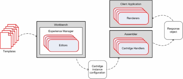

Cartridges are made up of several components that may be customized for specific purposes.
The following diagram shows the parts of a cartridge and where they fit within the overall architecture:
The cartridge template defines the configuration options that are available to the business user in Workbench. The Experience Manager interface is composed of editors, or Flex components that provide UI controls for specifying property values. Experience Manager produces the cartridge instance configuration that is consumed by the Assembler. During the processing of a query, the Assembler may invoke cartridge handlers that define specific processing logic for particular cartridges. Using these cartridge handlers, the Assembler produces the response object that it returns to the client application. Typically, the client application includes modular renderers that are intended to handle a particular cartridge.
