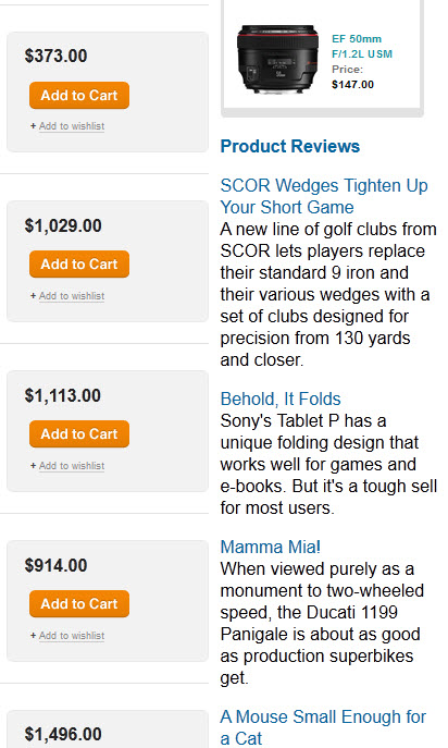

The renderer displays a summary of the results with links that take the site visitor to the site that originated the RSS feed.
To create a renderer for the RSS feed:
The results from the RSS feed display in the right sidebar.
The following shows the code for the sample RSS Feed renderer in JSP:
<%@page language="java" pageEncoding="UTF-8" contentType="text/html;charset=UTF-8"%> <%@include file="/WEB-INF/views/include.jsp"%> <div style="padding:2ex 0"> <b><a href="${component.chanUrl}">${component.chanTitle}</a></b> <c:forEach var="rssEntry" items="${component.entries}"> <p><a href="${rssEntry.itemUrl}">${rssEntry.itemTitle}</a><br/> ${rssEntry.itemDesc}</p> </c:forEach> </div>

, and then modify the version in your sample context file as indicated below.<bean id="CartridgeHandler_ResultsList" class="com.endeca.sample.cartridges.RecommendationsResultsListHandler" parent="NavigationCartridgeHandler" scope="prototype"> <property name="contentItemInitializer"> <!-- additional elements omitted from this example --> </property> <property name="sortOptions"> <!-- additional elements omitted from this example --> </property> <property name="recommendationService" ref="recommendationService" /> <property name="recordSpec" value="common.id"/> </bean> <bean id="recommendationService" class="com.endeca.sample.cartridges.TestRecommendationService" scope="singleton" > <!-- Implementation-specific configuration for the service could be specified here --> </bean>
The recommended records are boosted to the top of the results:
