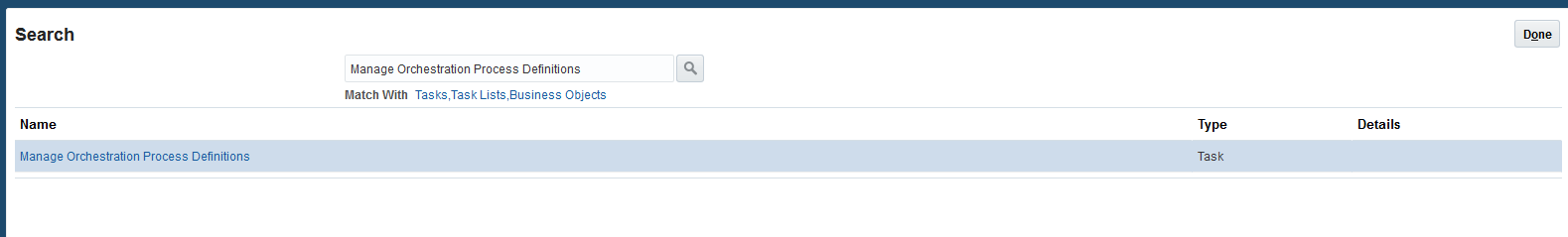

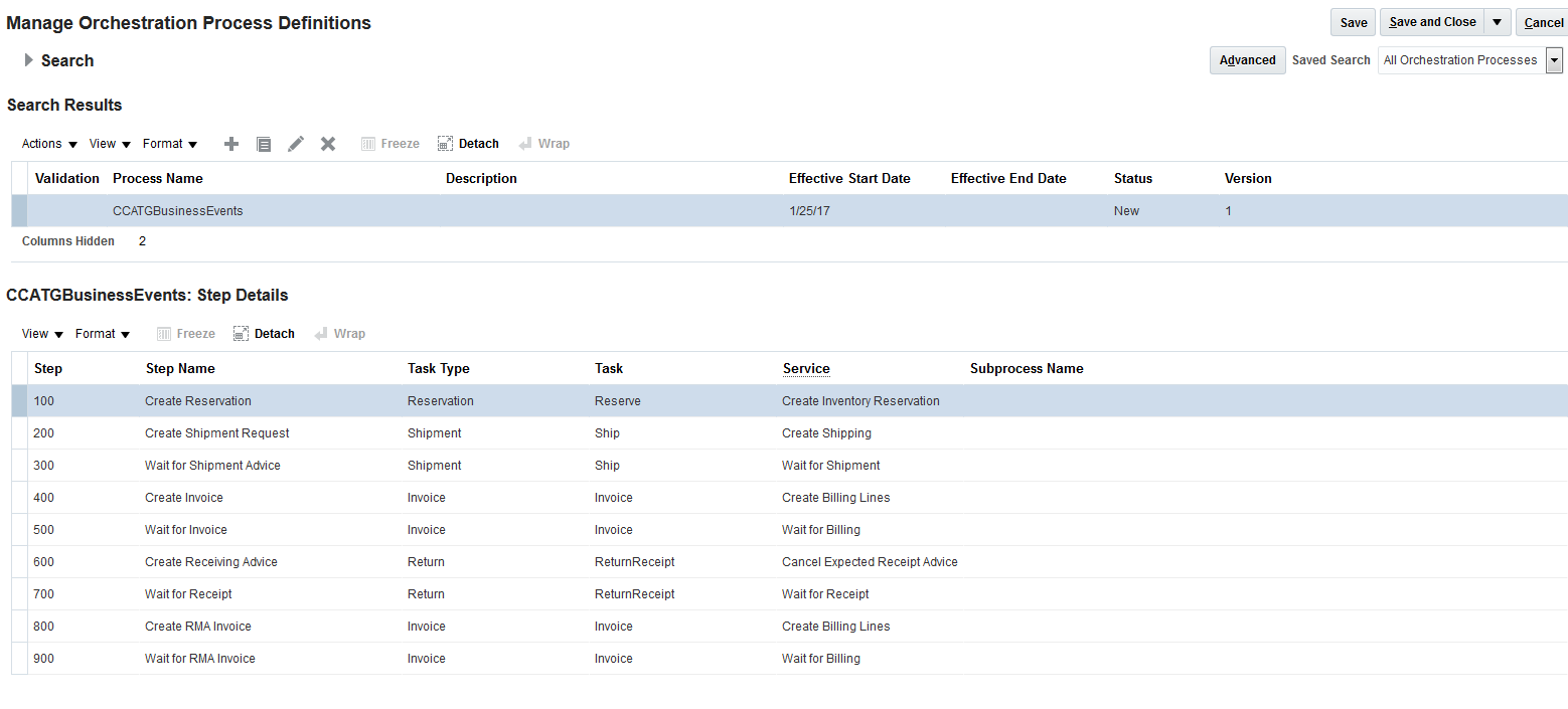

Go to the FSM link
https://domain.com/setup/faces/TaskListManagerTopand create the orchestration process:

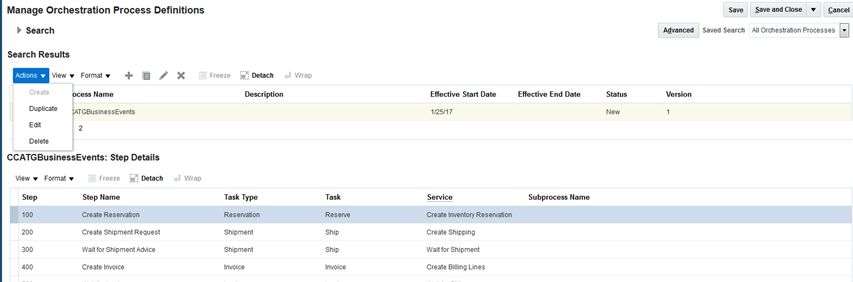

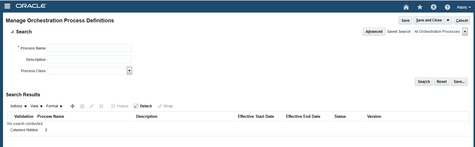

Search for process name that is created for Commerce Cloud.
A pre-defined process, CCATGBusinessEvents, is displayed.
Note: The processes can be created.

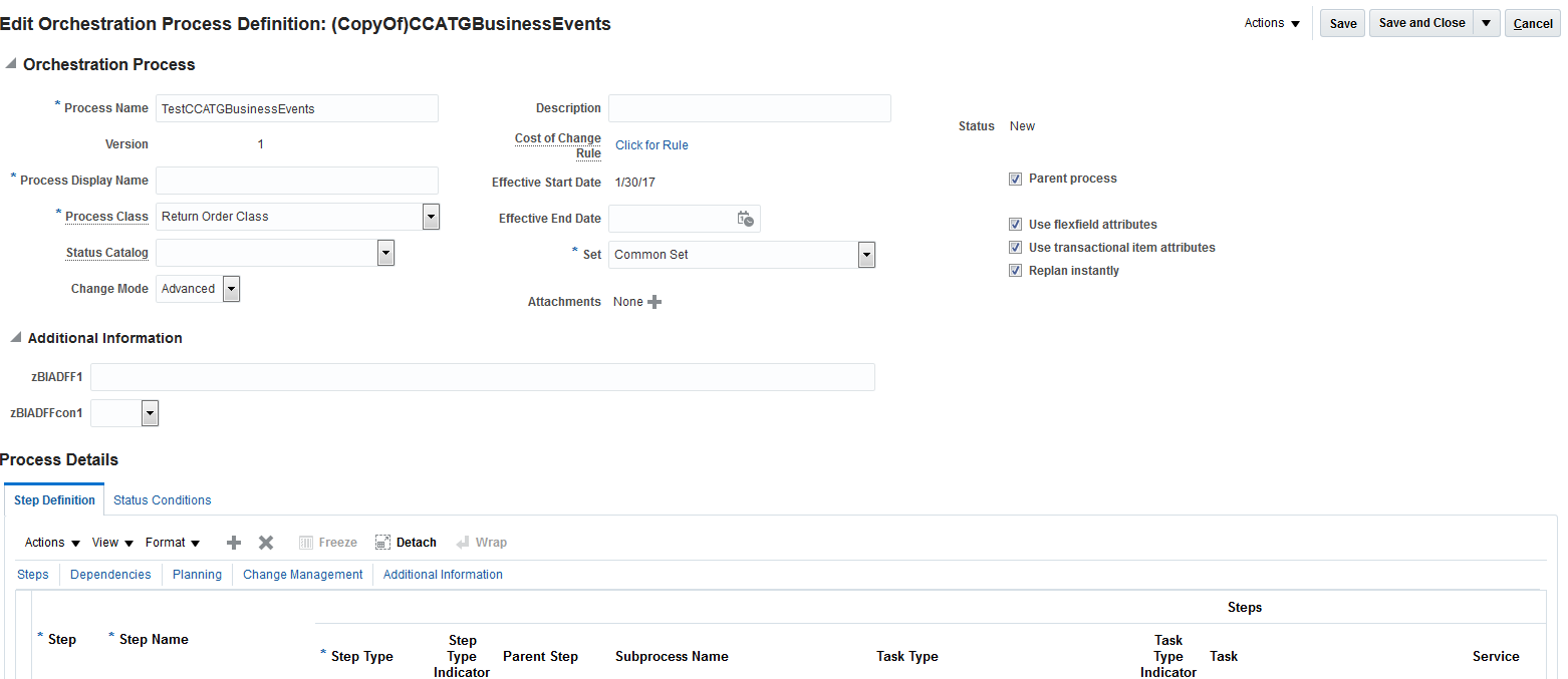

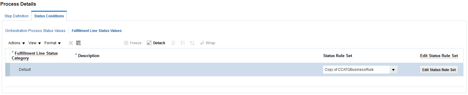

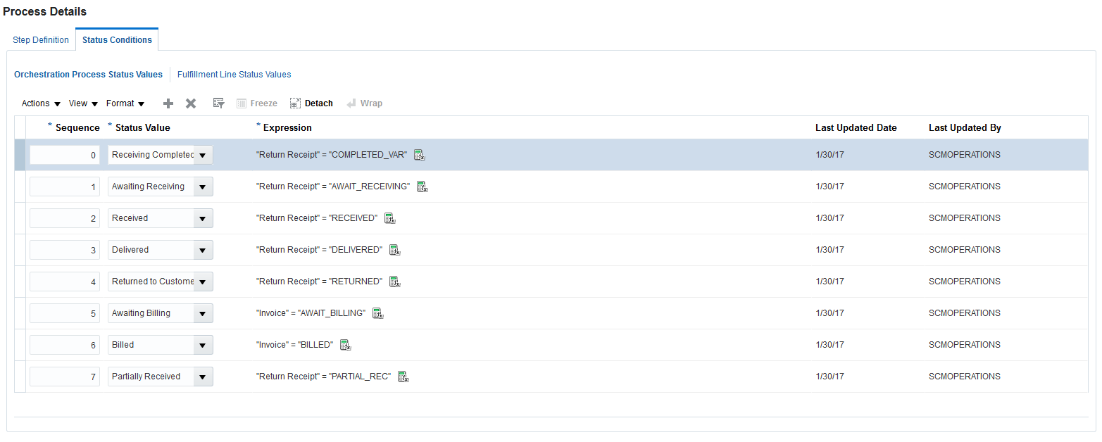

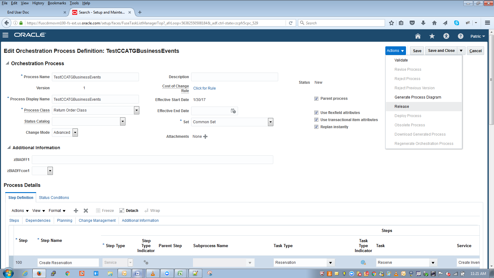

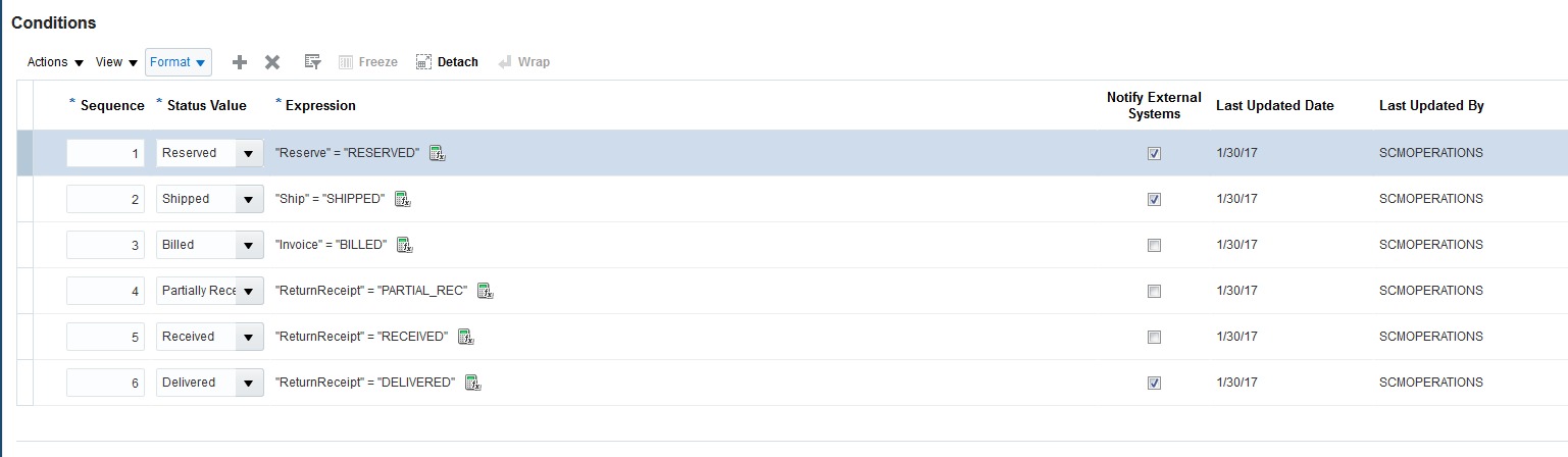

The following screens describe the orchestration details:
Click Edit Rule Set.
Save the details.
To release the process, click the release.
