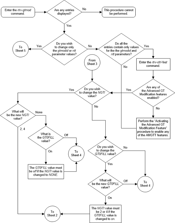

  1. Display the GT modification information in the database using the rtrv-gtmod command.
    This is an example of the possible output.
    rlghncxa03w 10-07-07 00:29:31 GMT EAGLE5 42.0.0
    GTMODID   NTT  NGTI  GT0FILL  NNP  NNAI  NPDD  NSDD  PRECD  CGPASSN
    modid2     --     2       ON   --    --    --    --    PFX       --
          NPDS=                       NSDS=
    modid5     --     2      OFF   --    --    --    --    PFX       --
          NPDS=                       NSDS=
    modid6     --     4       ON    4     5     3     3    SFX       --
          NPDS=123                    NSDS=456
    modid10    --    --      OFF    5     5    --    --    PFX       --
          NPDS=                       NSDS=
    modid11    --    --      OFF    5     5    --    --    PFX       --
          NPDS=                       NSDS=
    GTMOD table is (5 of 100000) 1% full.
    If entries are not displayed, this procedure cannot be performed.
    If entries are displayed, continue the procedure by performing one of these steps.
    • If only the gtmodid or ntt parameter values will be changed, continue the procedure with 6.
    • If the values for other parameters besides the gtmodid and ntt parameter values will be changed, continue the procedure by performing one of these steps.
      • If any of the entries shown in the rtrv-gtmod output contains values for parameters other than the gtmodid and ntt parameters, continue the procedure with 3.
      • If all of the entries shown in the rtrv-gtmod output contains only values for the gtmodid and ntt parameters, continue the procedure with 2.
  2. One of the Advanced GT Modification features must be enabled to change the values of the parameters other than the gtmodid and ntt parameters. Enter the rtrv-ctrl-feat command to verify if any of the Advanced GT Modification features are enabled.

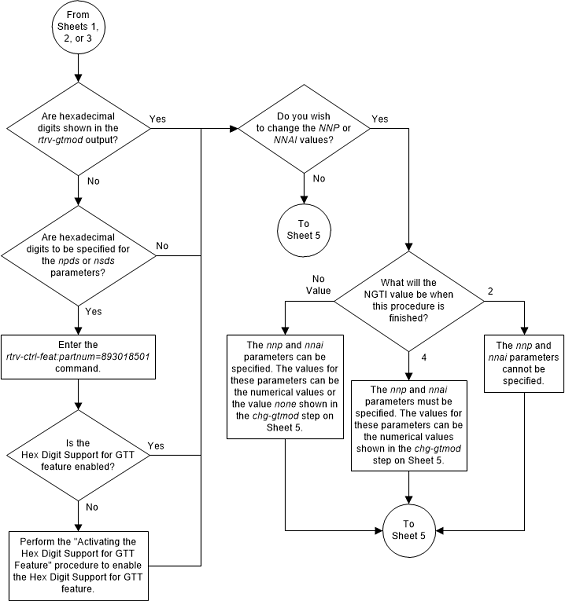

  3. For some parameters and values of the chg-gtmod command to be specified, these conditions must be present.
    To specify hexadecimal digits for the npds and nsds parameters, the Hex Digit Support for GTT feature must be enabled. If hexadecimal digits are shown in the rtrv-gtmod output, the Hex Digit Support for GTT feature is enabled.
    To specify the ngti parameter value 2 or 4, or the on=gt0fill parameter, the ANSI/ITU SCCP Conversion feature must be enabled. If values 2 or 4 for the ngti parameter are shown in the rtrv-gtmod output, or the GT0FILL value ON is shown in the rtrv-gtmod output, the ANSI/ITU SCCP Conversion feature is enabled.
    To specify the value none for the ngti parameter, the GT0FILL value must be OFF.
    If the gt0fill value will be changed to on, the ngti value must be 2 or 4.
    If the ngti value will be changed to 4, the nnp and nnai parameters must be specified and their values cannot be none. The network type of the point code in the entity that references the GT modification identifier that is being changed must be ITU.
    If the ngti value will be changed from 4 to 2, the nnp and nnai parameter values will be removed from the GT modification identifier.
    If the ngti value is 2 when this procedure is finished, the nnp and nnai parameters cannot be specified.
    If the ngti parameter will have no value when this procedure is finished (ngti=none), the nnp and nnai parameters can be specified.
    Continue the procedure with 6 if any of these conditions are present.
    • The Hex Digit Support for GTT and ANSI/ITU SCCP Conversion features are enabled.
    • If hexadecimal digits will not be specified for the npds or nsds parameters, and the ngti or the on=gt0fill parameters will not be specified with the chg-gtmod command.
    If hexadecimal digits will be specified for the npds or nsds parameters and hexadecimal digits are not shown in the rtrv-gtmod output, continue the procedure with 4.
    If the ngti parameter values 2 or 4, or the on=gt0fill parameter will be specified with the chg-gtmod command, and values 2 or 4 for the ngti parameter are not shown in the rtrv-gtmod output or the GT0FILL value ON is not shown in the rtrv-gtmod output, continue the procedure with 5.
    After these steps have been performed, as needed, continue the procedure with 6.

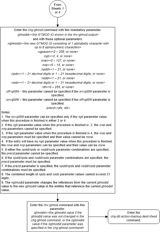

  6. Change the GT modification identifier using the chg-gtmod command with the parameters and values shown in Table 2-65.
    Table 2-65 Change GT Modification Parameter Values
    Mandatory Parameter
    :gtmodid=<the current GTMOD ID shown in the rtrv-gtmod output>
    Optional Parameters
    :cgpassn=<2 – 255, or none> :nsdd=<1 – 21, or none>
    :ngti=<2, 4, or none> :nsds=<1 – 21 decimal digits, 1 – 21 hexadecimal digits, or none>
    :nnai=<0 – 127, or none> :ntt=<0 – 255, or none>
    :nnp=<0 – 15, or none> :off=gt0fill – this parameter cannot be specified if the on=gt0fill parameter is specified.
    :npdd=<1 – 21, or none> :on=gt0fill – this parameter cannot be specified if the off=gt0fill parameter is specified.
    :npds=<1 – 21 decimal digits, 1 – 21 hexadecimal digits, or none>
    :precd=<pfx or sfx>
    pfx - the prefix digits (npds/npdd parameter values) of the received Global Title Address.
    sfx - the suffix digits (nsds/nsdd parameter values) of the received Global Title Address.
    :ngtmodid=<the new GTMOD ID consisting of 1 alphabetic character with up to 8 alphanumeric characters>
    Notes:
    1. At least one optional parameter must be specified.
    2. If either the npdd/npds or nsdd/nsds parameter combinations are specified, the precd parameter cannot be specified.
    3. If the npdd/npds and nsdd/nsds parameter combinations are specified, the precd parameter must be specified.
    4. If the precd parameter is specified, the npdd/npds and nsdd/nsds parameter combinations must be specified.
    5. The combined length of npds and nsds parameter values cannot exceed 21 digits.
    6. The ngtmodid parameter changes the references from the current gtmodid value to the new gtmodid value in the entities that reference the current gtmodid value.
    7. See 3 for other requirements for using these parameters.
    For this example, enter this command.
    chg-gtmod:gtmodid=modid6:ngti=2:gt0fill=off:precd=pfx:npdd=4:npds=2345 :nsdd=4:nsds=12ae:ngtmodid=modid7
    When the command has successfully completed, this message appears.
    rlghncxa03w 10-07-07 00:27:31 GMT EAGLE5 42.0.0
    CHG-GTMOD: MASP A - COMPLTD
  7. Verify the changes by entering the rtrv-gtmod command with the gtmodid parameter. The gtmodid parameter value is the gtmodid parameter value, if the GT modification identifier was not changed, or the ngtmodid parameter value, if the GT modification identifier was changed, that was specified in 6. For this example, enter this command.
    rtrv-gtmod:gtmodid=modid7
    rlghncxa03w 10-07-07 00:28:31 GMT EAGLE5 42.0.0
    modid7     --     2      OFF   --    --     4     4    PFX       --
          NPDS=2345                   NSDS=12ae
  8. Backup the new changes using the chg-db:action=backup:dest=fixed command. These messages should appear, the active Maintenance and Administration Subsystem Processor (MASP) appears first.
    BACKUP (FIXED) : MASP A - Backup starts on active MASP.
    BACKUP (FIXED) : MASP A - Backup on active MASP to fixed disk complete.
    BACKUP (FIXED) : MASP A - Backup starts on standby MASP.
    BACKUP (FIXED) : MASP A - Backup on standby MASP to fixed disk complete.
Figure 2-186 Change Global Title Modification Information - Sheet 1 of 5
Figure 2-187 Change Global Title Modification Information - Sheet 2 of 5
Figure 2-188 Change Global Title Modification Information - Sheet 3 of 5

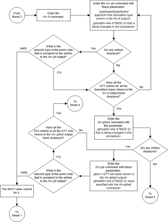

Figure 2-189 Change Global Title Modification Information - Sheet 4 of 5
Figure 2-190 Change Global Title Modification Information - Sheet 5 of 5
