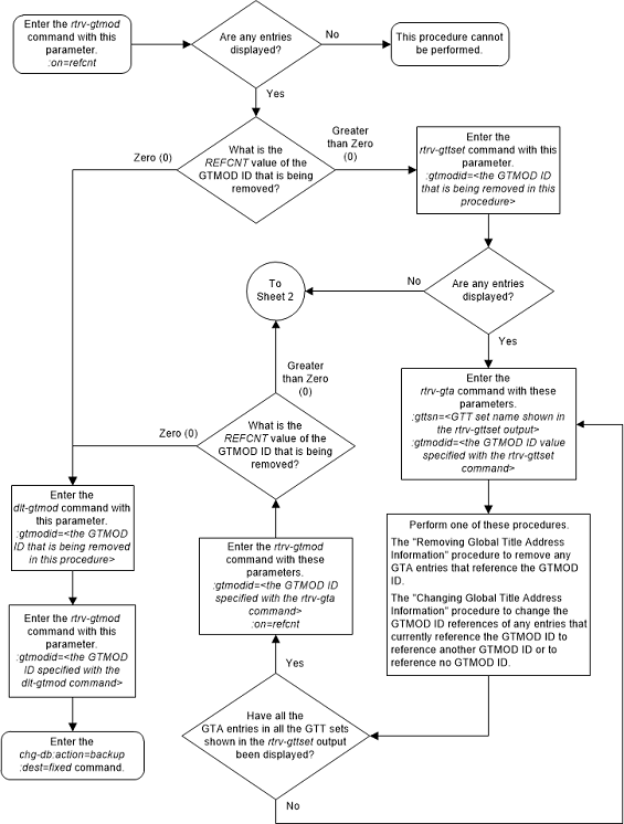

Figure 2-183 Remove Global Title Modification Information - Sheet 1 of 3

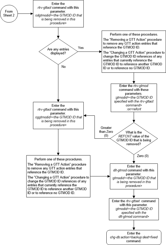

Figure 2-184 Remove Global Title Modification Information - Sheet 2 of 3

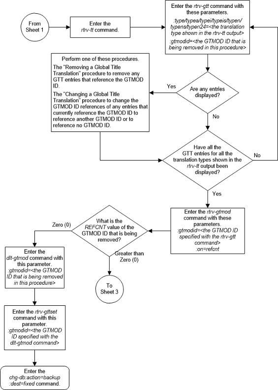

Figure 2-185 Remove Global Title Modification Information - Sheet 3 of 3
