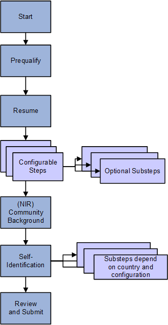

Steps in the Online Application Process
Candidate Gateway guides applicants through the steps in the job application.
The site definition, the resume template, and the job opening(s) can all impact the steps that appear during the application process. Although configuration options affect which steps appear, the overall sequence of steps is fixed, as shown in the following diagram.
See The Activity Guide Framework for Job Applications.
Image: Steps in the job application process
This diagram illustrates the sequence of steps during the job application process.
Steps in the Fluid Candidate Gateway job application process
The following table describes the application steps and explains what causes each step to appear.

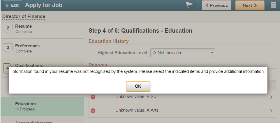

    Sometimes the resume parsing process will create a row of data that is missing required information. In this situation, the system prevents the applicant from moving past the step with the missing information until all required data is supplied. A red warning icon identifies the incomplete data, and the applicant must resolve the issue before continuing to the next step.
    If an applicant returns to the resume step and supplies a new resume, the newly extracted data replaces the previous data, and the applicant must go through each application step again to verify the newly extracted information.
Image: Error handling for resume parsing
This example illustrates the error handling when the resume parser creates a row of data that is missing required information.
