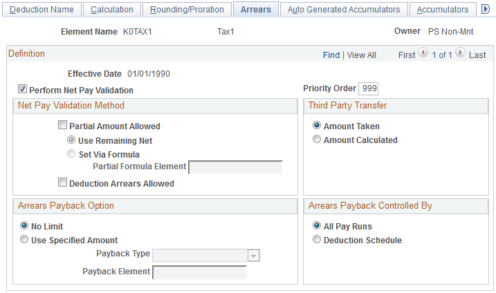

Define the rules that apply when net pay is insufficient to cover a deduction.
Use the Deductions - Arrears page to define these rules. An arrears is a way to store deductions that the system can't take from the current pay run because of insufficient net pay. An arrears stores an amount that will be deducted at a future time.

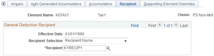

Select a general recipient, if applicable for the deduction using the Deductions - Recipient page.

When defining a deduction, you can define the action the system takes when a payee's net pay is not sufficient to cover the entire amount of a deduction. You can also establish a payback method for the amount that is not taken (the arrears).
Note: Before you define deductions for your organization, you may want to decide whether you want the system to perform the functions described on the Deduction - Arrears page or whether you want to handle these functions on your own.
Net Pay Validation
The net pay validation feature prevents a deduction from reducing net pay below zero or a minimum amount that you define. To use the system's arrears management and payback features, you must enable net pay validation. If you do not use net pay validation, the system always takes the entire amount of a deduction, even if the payee's net pay drops below zero. In addition, none of the arrears processing options are available.
When using net pay validation, you can specify the order for taking deductions when there's not enough net pay to cover all deductions. The choices are:

Specify the priority order for the deduction on the Deduction - Arrears page.

If you select the Deduction Arrears Allowed check box on the Deduction - Arrears page, the Add to Arrears equals the Amount Not Taken.
Arrears Balance
This accumulator keeps track of the arrears for a payee. The Add to Arrears component adds to this balance accumulator; the Payback Amount component subtracts from it.
Arrears Processing Methods
When net pay does not cover the entire amount of a deduction, you can have the system deduct a partial amount or nothing. The options that you select in the Deduction Processing Method group box on the Deduction - Arrears page determine this behavior. The two examples that follow illustrate the outcomes of the different processing methods.
Arrears Processing: Example 1 (Partial Amount Allowed = No)
If partial deductions are not allowed, the system takes a deduction for the current pay period only if net pay covers the entire deduction. If the full deduction can't be taken, the system adds the entire deduction amount to the arrears balance. This table lists the net pay, deduction, and arrears for the example that follows:

Use the Deductions - Arrears page (GP_ERN_DED_ARR) to specify what to do when available net pay is insufficient to cover the deduction, how to pay back arrears, and how the third-party recipient is to be paid, if there is an arrears balance.
Navigation
Image: Deductions - Arrears page
This example illustrates the fields and controls on the Deductions - Arrears page.
Field or Control |
Definition |
| Perform Net Pay Validation |
Select to enable net pay validation for this deduction. Net pay validation prevents the system from reducing net pay below zero or a defined minimum when a payee's net pay is insufficient to cover the deduction. (You can select Partial Amount Allowed and Deduction Arrears Allowed to specify whether the deduction is to be taken and how much is to be taken.) If you do not select this check box, the system takes the full amount of the deduction, even if net pay becomes negative. You must define what to do with the negative balance. To prevent net pay from dropping below a minimum amount other than zero, define the minimum on the Process List - Definition page. Note: Other fields on this page are available for entry only if you select this check box. |
| Priority Order |
Specify the priority of this deduction, relative to other deductions, when the system detects that the payee's net pay is insufficient to cover all deductions. The default value is 999, which is also the maximum value. Deductions with a low priority number have the highest relative priority. For example, the system will try to deduct funds for an element that has a priority of 1, before it tries to cover other deductions. If more than one deduction has the same priority number, net pay validation is applied to deductions in the order in which they're encountered in the section (that is, in processing sequence). If a deduction has more than one instance, priority order is the reverse of processing order. So, if there are instances 1, 2, and 3 for element D1, processing order would be 1, 2, 3. Net pay validation would follow this order: 3, 2, 1. Note: This field applies when you base net pay validation on a deduction's priority. It appears only when a net pay validation formula is associated with the country for which the deduction element is defined or when the deduction is defined for use by all countries. Use the Countries page to select a country's net pay validation formula. See Understanding Net Pay Validation and Arrears Processing. |
Net Pay Validation Method
Your selections in this group box instruct the system on how much, if any, of the deduction should be processed and whether to track the amount not taken as an arrears balance.
Field or Control |
Definition |
| Partial Amount Allowed |
Select to have the system deduct a partial amount when the deduction exceeds available net pay (or the minimum net defined on the Process List - Definition page). Specify how much the system is to deduct by selecting one of the following options: Use Remaining Net: This option causes the system to deduct the remaining available net pay. For example, if a payee has net pay of 100 and the deduction is 120, the system deducts 100. If you defined a minimum net pay, the system does not deduct below the minimum. Set Via Formula: With this option, the system uses a formula to determine the amount to deduct. Set Via Formula is especially useful for pretax deductions when you base net pay validation on priority order. You can create a formula that sets the partial amount to an amount that's less than the remaining net, for example, to a third of the remaining net. This can reduce the number of loops the system needs to make through a net pay validation subprocess section. The formula should assign the partial amount to the system element OVRD CURR AMT VAL. Since rounding on the resolved amount happens prior to Net Pay Validation processing, you need to apply rounding to the partial amount, according to your rounding requirements, in this formula. During processing, the system checks to see if the value of this element is greater than zero and less than or equal to the remaining net (system element NET AVAILABLE) taking the minimum net into account. If OVRD CURR AMT VAL is less than zero or greater than NET AVAILABLE, the deduction and payment are put in error. The formula might look
something like this: In this case, the formula determines the partial amount by dividing the remaining net amount that was calculated during the first pass by two. If you don't select the Partial Amount Allowed check box, and the system can't deduct the entire amount, it will not deduct any of the amount from the payroll. The resolved amount is zero. |
| Partial Formula Element |
If you select Set Via Formula , enter the formula here. |
| Deduction Arrears Allowed |
If you select this check box, and a deduction exceeds available net pay, the system stores the deduction amount in an accumulator (an arrears balance). This is how the system keeps track of the Amount Not Taken (either a partial amount or the entire amount, depending on whether you selected the Partial Amount Allowed option) and knows that it has to take the amount from a future payroll. Indicate how much you want paid back in future payrolls in the Payback Option group box. If Perform Net Pay Validation is selected, the system always tracks the Amount Not Taken. Only if you select Deduction Arrears Allowed does the Amount Not Taken move into the Add to Arrears component and become eligible for payback. This in turn adds to the arrears balance. |
Third Party Transfer
Indicate how much of the deduction to send to the deduction recipients. (You define recipient information on the Deductions - Recipients page.)
Field or Control |
Definition |
| Amount Taken |
Select this option if you plan to send only the amount that was resolved for the payee. This does not include any amount stored in the amount not taken component. |
| Amount Calculated |
Select this option to send the amount that was calculated (the resolved amount plus amount not taken). |
Example: Comparing Third Party Transfer Methods
The end result of Amount Taken and Amount Calculated is the same, once the arrears amount is paid back. Assume the following:
D1 = Amount Taken; value = 100
D2 = Amount Calculated; value = 100
In period 1, 50 is taken for D1 and zero for D2 because of insufficient net pay. For D1, 50 is sent (the amount taken). For D2 100 is sent (resolved amount plus amount not taken).
In period 2, net pay is sufficient to cover the current and payback amounts for both deductions. D1 resolves to 150 (100 current plus 50 payback). D2 resolves to 200 (100 current plus 100 payback). For D1, 150 is sent (current plus payback); for D2, 100 is sent (current only). After period 2, 200 is sent for each deduction.
Arrears Payback Option
Field or Control |
Definition |
| No Limit |
Select this option to have the system try to deduct the entire arrears balance. For example, assume a payee has an arrears balance of 200 after the first payroll. If you select No Limit, the next time a payroll is processed, the system tries to deduct 200, the entire amount of the arrears balance. This is known as the Payback Amount. |
| Use Specified Amount |
Select this option to specify the maximum payback amount by entering a numeric value or by selecting a bracket, formula or variable element. |
| Payback Type |
This field is available only when you select Use Specified Amount. Select the type of element that returns the maximum payback amount—that is, the maximum amount the system deducts from each payroll until the arrears balance is zero. Values are: Bracket, Formula, Numeric, and Variable. |
| Payback Element |
Select the element to return the maximum payback amount or enter the numeric value. For variables, brackets, and formulas, only elements with a decimal or monetary field format are allowed. Note: The system uses the currency that is defined for the element on the Earnings or Deduction Calculation page. If no currency is defined on that page, it uses the currency that is defined on the User Preferences page. |
Arrears Payback Controlled By
Specify when paybacks are paid.
Field or Control |
Definition |
| All Pay Runs |
Select this option to have the arrears payback occur every time a person is paid and for every segment that's processed for that payee, even for periods where generation control conditions exist. |
| Deduction Schedule |
Select to have the system perform the payback function only when the deduction is resolved. For example, you may have a deduction that is scheduled for processing (resolved) only in the first weekly period of every month (for a weekly payroll). If during this period, an arrears is created for the payee, the system will not perform the payback function until the first weekly period of the next month (controlled by generation control). However, if positive input is entered for the nonscheduled periods, the system will perform the payback function. |

Use the Deductions - Recipient page (GP_RCP_DED) to select a general recipient for a deduction (the entity that receives all amounts that are withheld from payees for a particular deduction, such as a government agency).
Navigation
Image: Deductions - Recipient page
This example illustrates the fields and controls on the Deductions - Recipient page.
Note: Define the general recipient on the Deduction Recipient page first. If you want to use a formula to identify the recipient, define the formula first.
Field or Control |
Definition |
| Recipient Selection |
Select the parameter by which you select a recipient for the deduction. Values are: Recipient Name: Select to make the available values in the Recipient field prompt from the Recipient ID Table. Recipient by Formula: Select to make the available values in the Recipient field prompt from formula names. |
| Recipient |
Select the recipient for this deduction. Identify the general recipient of all amounts that are withheld for this deduction, if applicable. (You designate a recipient category—general or individual—through the Deduction Recipients component that is described in the Banking section.) Leave this field blank if you want to assign the recipient at the payee level (as you might with garnishments, for example). Instead, use the Payee Deduction Recipients page to identify the individual recipient(s) of the amounts deducted for a particular payee. If more than one individual recipient is identified for a given payee/deduction (for deductions that have multiple resolutions), you may then use the Element Assignment By Payee or the Payee Assignment By Element page to identify the individual recipient for the instance. Note: When you assign a general recipient to a deduction, you can override the recipient for a particular payee. This can be done by setting up individual recipients through Payee Deduction Recipients page and then using the Element Assignment By Payee or Payee Assignment By Element as necessary. |
