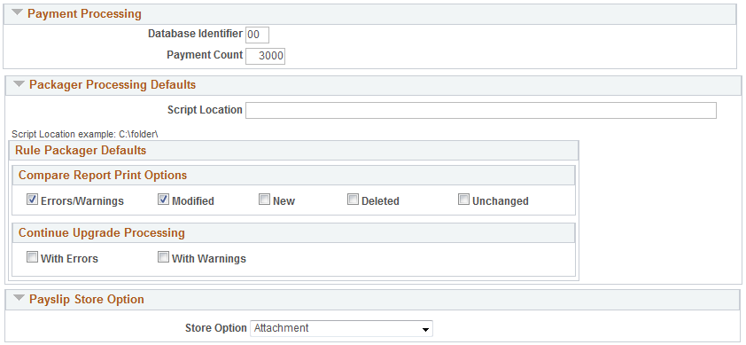

Payment Processing
Use this group box to define database-specific payment processing settings that are used when communicating payment information.
Field or Control
Definition
Database Identifier
Enter a unique alphanumeric identifier that the system adds to payment messages that it sends.
Payment Count
Enter the number of payments that you want the system to chunk together with each payment message. For example, if you enter 3000 here, the system will create and publish a separate payment message for every 3000 rows of payment data.
Packager Processing Defaults
Field or Control
Definition
Script Location
Enter the location where DMS scripts are created. The default will be blank. An example displays below the field to let you know how to enter the script location.
Note: The value will default for the rule and non-rule packages. This script location should match the location set up for the PSNT process scheduler in which you are using. This is set up in the psconfig.cfg file.
Compare Report Print Options
This group box controls the sections of the Compare Report that will be printed. Select the sections of the report to print . The options on the Packager Processing page will default the values selected each time you run a Compare Report. The check boxes can be overridden on the processing pages.
Values for the report sections include:
  • Errors/Warnings – Select to print the warning or errors that have occurred during the compare.
  • Modified – Select to print the elements that are different from the ones in the target database.
The above two options reflect the delivered defaults.
  • New – Select to print the new elements.
  • Deleted – Select to print the elements that will be deleted.
  • Unchanged – Select to print the elements that have not changed.
Continue Upgrade Processing
This group box controls the ability to upgrade when there are errors or warnings. The default for each value is cleared.
Valid values include:
  • With Errors – Select to upgrade the package even if there are errors after the compare.
  • With Warnings – Select to upgrade the package even if there are warnings after the compare.

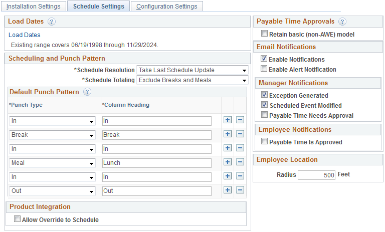

Use the Schedule Settings page (TL_INSTL_PUNCH) to define default settings for work schedules.
Image: Schedule Settings page
This example illustrates the fields and controls on the Schedule Settings page.
Important! This page (TL_INSTL_PUNCH) is the same as the Configurations Page for Time and Labor. The settings that you define on this page are shared between Time and Labor, Global Payroll, and Absence Management.
Field or Control
Definition
Load Dates
Click to access the Dates Table Load page where you can load the range of dates to be used in schedules. Dates from 1994 to 2014 are pre-loaded. You need only use this feature to load dates before or after this date range.
Schedule Resolution
Specify how to resolve schedule changes.
Select Take Last Schedule Update to have the system use the last update to resolve an employee's schedule, whether the update comes from a third-party, workforce scheduling system or an online override.
Select Take Online Override to have the system look for an online schedule override to resolve the schedule for the day. The system does not look for changes from a third-party workforce scheduling system.
Schedule Totaling
This field applies only if People Soft Enterprise Time and Labor is installed. Specify whether to include or exclude meal times, breaks, or both in the scheduled hours totals on schedule definitions, shift definitions, and the Manage Schedules page. Options are Exclude Meals and Breaks, Include Meals and Breaks, Include Meals, and Include Breaks. The default is Include Breaks.
Default Punch Pattern
Specify the default sequence for displaying punch types on the scheduling pages. You can also use the Grid Column Heading fields to modify the punch type labels that are to appear as column headings on the schedule pages.
Payable Time Approvals
Field or Control
Definition
Retain basic (non-AWE) model (retain basic non-Approval Workflow Engine model)
Select to use the basic model for approving Time and Labor payable time instead of Approval Workflow Engine.
Email Notifications
Field or Control
Definition
Enable Notifications
Select to enable email notifications. You cannot select any of the check boxes in the Manager Notifications or Employee Notifications group boxes unless the Enable Notifications check box is selected.
Field or Control
Definition
Exception Generated
Select to generate a notification when an exception is generated.
Scheduled Event Modified
Select to generate a notification when a scheduled event is modified.
Payable Time Needs Approval
Select to generate a notification when payable time needs approval.
Field or Control
Definition
Payable Time Is Approved
Select to generate a notification when payable time is approved.

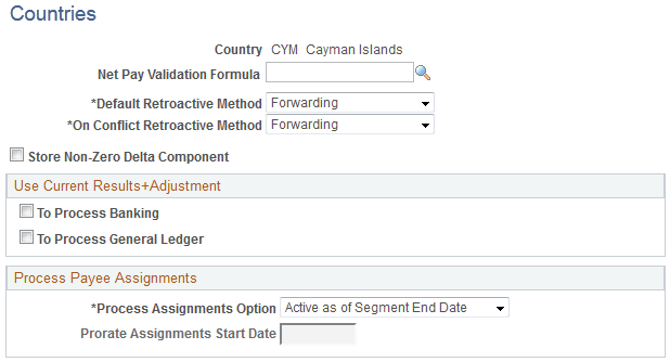

Use the Countries page (GP_COUNTRY) to define country-level setup parameters, such as the net pay validation formula, the default retroactive method, and banking and general ledger processing.
Image: Countries page
This example illustrates the fields and controls on the Countries page.
Countries page
Field or Control
Definition
Net Pay Validation Formula
Select the net pay validation formula to use for this country if you intend to use the net pay validation by priority feature. Net pay validation prevents a deduction from reducing net pay below zero or a minimum amount that you define. With net validation by priority, after the system calculates all deductions according to processing sequence, it resolves the formula that you specify here for each deduction starting with the deduction with lowest priority (the highest priority number). The formula returns a value that tells the system whether to calculate the element, perform net pay validation, do both, or skip the element. Guidelines for creating the formula are provided in the topic on Defining Processing Elements.
Note: Net pay validation is discussed in detail later in this product documentation.
See Understanding Net Pay Validation and Arrears Processing.
Default Retroactive Method
Select a Default Retroactive Method to use for the selected country. Values are Corrective and Forwarding.
On Conflict Retroactive Method
Select which retroactive method, Corrective or Forwarding, to use when:
  • An employee is associated with more than one pay group or pay entity.
  • Two calendars with the same period ID each use different retroactive methods within the same calendar group.
Process Payee Assignments
The Process Assignments Option field determines when to process earning or deduction payee assignments. The options are:
  • Active as of the Segment End Date: Select to have an element entered on the payee assignment page processed if the assignment is active as of the segment end date.
  • Active Anytime within Segment: Select to have an element entered on the payee assignment page processed and prorated for rows falling within a segment in addition to rows active as of the segment end date.
    Note: This option is used when the proration of earning/deduction assignments is desired. This is the first in a series of steps to setting up the proration of earning/deduction assignments functionality. Additionally a segmentation trigger definition must be defined for the payee assignment record (GP_PYE_OVRD).
    See Understanding Segmentation Setup.
Prorate Assignments Start Date
If the Process Assignment Option is Active Anytime within Segment, enter a start date to prorate the assignment. When the date is left blank, the proration functionality is in effect for all time periods processed (including retro periods). When a start date is entered, the proration functionality is in effect on or after the date specified. This avoids impacting prior rows which could otherwise change retro results.
Store Non-Zero Delta Component
Select this check box in order for the system to store any delta amount or delta component that has a nonzero value, regardless of the setting on the Element Name (GP_PIN) page, Results group box for the element. deselect this check box in order for deltas to inherit the element's store option.
The following table provides an overview of how the system interprets the check box settings at different levels:
Element Store Option
Country Delta Option
Element is Stored
Country is Stored
ON
ON
YES
YES
ON
OFF
YES
YES
OFF
ON
NO
YES
OFF
OFF
NO
NO
Note: Additional information regarding retroactivity is discussed in detail in another topic in this product documentation.
See Understanding Retroactive Methods.
Use Current Results + Adjustment
If you select either To Process Banking or To Process General Ledger in this group box, the effect is different depending on the retroactive method.
  • If the Default Retroactive Method is Corrective, the enhancement does not change the behavior of corrective retroactivity in banking or general ledger.
  • If the Default Retroactive Method is Forwarding, the system does not reverse prior amounts or post recalculated amounts during retroactive processing. Instead, the system implements current results (V1R1) plus adjustments in banking or general ledger, depending on which check boxes you select.
    Note: Additional information regarding what happens during retroactivity in relation to banking and General Ledger is discussed in other topics in this product documentation.
    See Understanding Banking.
    See Understanding the General Ledger Interface.
