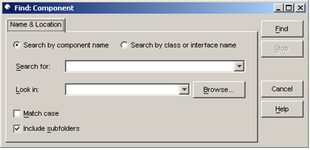

When changing Oracle Commerce Platform component configuration, you can use the ACC to search for components by name, class or interface.
To search for a component:
Choose File > Find Component in the main ACC window. The Find Component dialog box opens, as shown below.
Click the radio button that indicates the way you want to search: Search by component name or Search by class or interface name.
Type the component name in the Search for field. You can search for partial names by using the asterisk (*) or question mark (?) wildcard symbols. If you want your search to be case-sensitive, check the Match case box.
Type the location you want to search in the Look in field or click the Browse button to select a directory from the component hierarchy. To search all folders within this directory, make sure the Include subfolders box is checked.
Click the Find button. The search results appear at the bottom of the Find : Component dialog box.
