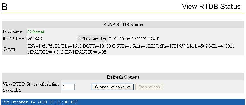

  8. Select RTDB>View RTDB Status to verify that the RTDB status on both sides is coherent, as shown in Figure 4-2.
    Figure 4-2 Coherent RTDB Status
