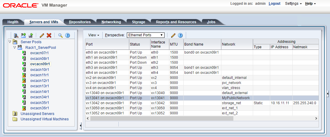

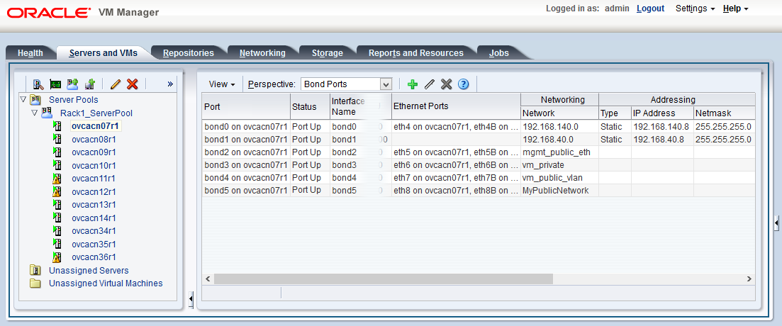

- Connect the required servers to the new custom network. You must provide the network name and the names of the servers to connect. - PCA> add network - MyPublicNetwork- ovcacn07r1Status: Success PCA> add network- MyPublicNetwork- ovcacn08r1Status: Success PCA> add network- MyPublicNetwork- ovcacn09r1Status: Success
- Verify the configuration of the new custom network. - PCA> show network - MyPublicNetwork---------------------------------------- Network_Name MyPublicNetwork Trunkmode None Description None Ports ['1:1', '1:2'] vNICs None Status ready Network_Type external_network Compute_Nodes ovcacn07r1, ovcacn08r1, ovcacn09r1 Prefix None Netmask None Route Destination None Route Gateway None ---------------------------------------- Status: Success- As a result of these commands, a VxLAN interface is configured on each of the servers to connect them to the new custom network. These configuration changes are reflected in the Networking tab and the Servers and VMs tab in Oracle VM Manager. Note- If the custom network is a host network, the server is assigned an IP address based on the prefix and netmask parameters of the network configuration, and the final octet of the server's internal management IP address. - For example, if the compute node with internal IP address 192.168.4.9 were connected to the host network used for illustration purposes in this procedure, it would receive the address 10.10.10.9 in the host network. - Figure 2.7 shows a custom network named MyPublicNetwork, which is VLAN-capable and uses the compute node's - vx13041interface.
- Verify the configuration of the new custom network. - PCA> show network - MyPublicNetwork---------------------------------------- Network_Name MyPublicNetwork Trunkmode True Description User defined network Ports ['4:2', '5:2'] vNICs ovcacn09r1-eth8, ovcacn07r1-eth8, ovcacn08r1-eth8 Status ready Network_Type external_network Compute_Nodes ovcacn07r1, ovcacn08r1, ovcacn09r1 Prefix None Netmask None Route Destination None Route Gateway None ---------------------------------------- Status: Success- As a result of these commands, a bond of two new vNICs is configured on each of the servers to connect them to the new custom network. These configuration changes are reflected in the Networking tab and the Servers and VMs tab in Oracle VM Manager. Note- If the custom network is a host network, the server is assigned an IP address based on the prefix and netmask parameters of the network configuration, and the final octet of the server's internal management IP address. - For example, if the compute node with internal IP address 192.168.4.9 were connected to the host network used for illustration purposes in this procedure, it would receive the address 10.10.10.9 in the host network. - Figure 2.8 shows a custom network named MyPublicNetwork, which is VLAN-enabled and uses the compute node's - bond5interface consisting of Ethernet ports (vNICs)- eth8and- eth8B.
