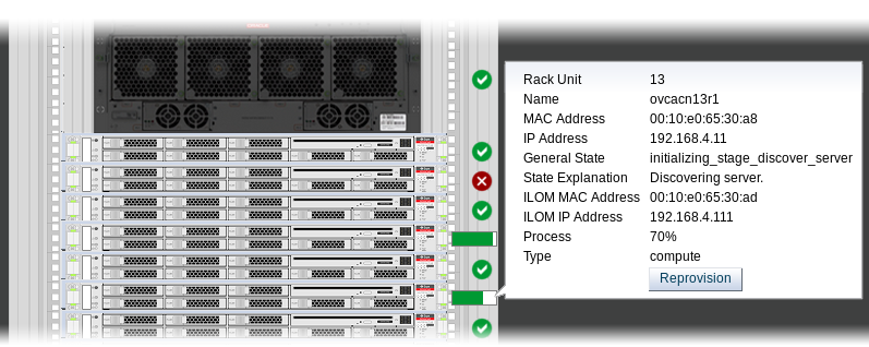

- Log in to the Oracle Private Cloud Appliance Dashboard.
- Go to the Hardware View tab.
- Roll over the compute nodes that are in Error status or have become stuck in the provisioning process. - A pop-up window displays a summary of configuration and status information.
- If the compute node provisioning is incomplete and the server is in error status or stuck in an intermittent state for several hours, click the Reprovision button in the pop-up window.
- When the confirmation dialog box appears, click OK to start reprovisioning the compute node.
