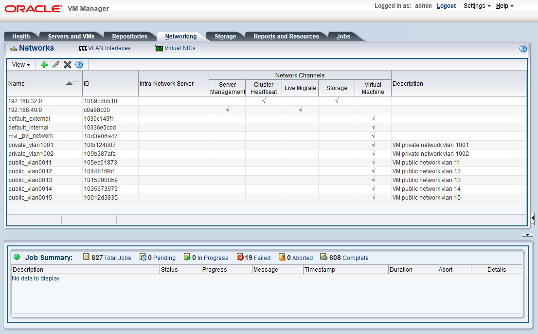

On a system with an Ethernet-based network architecture, default networks are set up as follows:
- 192.168.32.0: the internal management network- This is a private network providing connectivity between the management nodes and compute nodes, using VLAN 3092. It is used for all network traffic inherent to Oracle VM Manager, Oracle VM Server and the Oracle VM Agents.
- 192.168.40.0: the internal storage network- This is a private network used exclusively for traffic to and from the ZFS storage appliance. Both management nodes and compute nodes can reach the internal storage on VLAN 3093. The network also fulfills the heartbeat function for the clustered Oracle VM server pool.
Additionally, two networks are listed with the VM Network role:
- default_external- This default network is the standard choice for virtual machines requiring external network connectivity. It supports both tagged and untagged traffic. For untagged traffic it uses the Oracle VM standard VLAN 1, meaning no additional configuration is required. - If you prefer to use VLANs for your VM networking, configure the additional VLAN interfaces and networks of your choice as follows: Note- When reprovisioning compute nodes or provisioning newly installed compute nodes, you always need to configure VLANs manually. The VLAN configuration is not applied automatically when the compute node joins an existing server pool. - Go to the Networking tab and select the VLAN Interfaces subtab. - The process for creating VLAN Interfaces is described in detail in the Oracle VM Manager User's Guide in the section entitled Create VLAN Interfaces.
- Click Create VLAN Interface. In the navigation tree of the Create VLAN Interfaces window, select the - vx13040VxLAN interface of each compute node in the default Rack1_ServerPool.
- In the next step of the wizard, add the VLAN IDs you require. When you complete the wizard, a new VLAN interface for each new VLAN ID is configured on top of each compute node interface you selected.
- Create a new Oracle VM network with the VM role, on the VLAN interfaces for each VLAN tag you created. Each new network should contain the VLAN interfaces associated with a particular VLAN ID; for example all VLAN interfaces with ID 11 on top of a - vx13040interface.Tip- You can filter the VLAN interfaces by ID to simplify the selection of the VLAN interfaces participating in the new network. - The process for creating networks with VLAN interfaces is described in the Oracle VM Manager User's Guide in the section entitled Create New Network. Note- To start using the new network at the VM level, edit the necessary VMs and assign a VNIC to connect to the new network.
- Configure your data center network accordingly.
- default_internal- This default network is intended for virtual machines requiring network connectivity to other virtual machines hosted on the appliance, but not external to the appliance. For untagged traffic it uses the Oracle VM standard VLAN 1. To use the VLANs of your choice, configure the additional VLAN interfaces and networks as follows: Note- When reprovisioning compute nodes or provisioning newly installed compute nodes, you always need to configure VLANs manually. The VLAN configuration is not applied automatically when the compute node joins an existing server pool. - Go to the Networking tab and select the VLAN Interfaces subtab. - The process for creating VLAN Interfaces is described in detail in the Oracle VM Manager User's Guide in the section entitled Create VLAN Interfaces.
- Click Create VLAN Interface. In the navigation tree of the Create VLAN Interfaces window, select the - vx2VxLAN interface of each compute node in the default Rack1_ServerPool.
- In the next step of the wizard, add the VLAN IDs you require. When you complete the wizard, a new VLAN interface for each new VLAN ID is configured on top of each compute node network port you selected.
- Create a new VLAN network with the VM role for each VLAN tag you added. Each new network should contain the VLAN interfaces associated with a particular VLAN ID; for example all VLAN interfaces with ID 1001 on top of a - vx2interface.Tip- You can filter the VLAN interfaces by ID to simplify the selection of the VLAN interfaces participating in the new network. - The process for creating networks with VLAN interfaces is described in the Oracle VM Manager User's Guide in the section entitled Create New Network.
For more information about Oracle Private Cloud Appliance network configuration, see Section 1.2.4, “Network Infrastructure”.

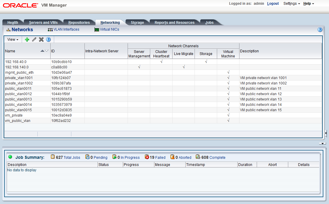

On a system with an InfiniBand-based network architecture, default networks are set up as follows:
- 192.168.140.0: the management network- This is a private network used exclusively for Oracle VM management traffic. Both management nodes and all compute nodes are connected to this network through their - bond0interface.
- 192.168.40.0: the storage network- This is a private IPoIB network used exclusively for traffic to and from the ZFS storage appliance. Both management nodes and both storage controllers are connected to this network through their - bond1interface.
Additionally, three networks are listed with the VM Network role:
- vm_public_vlan- This default network is the standard choice for virtual machines requiring external network connectivity. It supports both tagged and untagged traffic. For untagged traffic it uses the Oracle VM standard VLAN 1, meaning no additional configuration is required. - If you prefer to use VLANs for your VM networking, configure the additional VLAN interfaces and networks of your choice as follows: Note- When reprovisioning compute nodes or provisioning newly installed compute nodes, you always need to configure VLANs manually. The VLAN configuration is not applied automatically when the compute node joins an existing server pool. - Go to the Networking tab and select the VLAN Interfaces subtab. - The process for creating VLAN Interfaces is described in detail in the Oracle VM Manager User's Guide in the section entitled Create VLAN Interfaces.
- Click Create VLAN Interface. In the navigation tree of the Create VLAN Interfaces window, select the - bond4port of each compute node in the default Rack1_ServerPool.
- Create a new VLAN network with the VM role for each VLAN tag you added. Each new network should contain the VLAN interfaces associated with a particular VLAN ID; for example all VLAN interfaces with ID 11 on top of a - bond4port.Tip- You can filter the VLAN interfaces by ID to simplify the selection of the VLAN interfaces participating in the new network. - The process for creating networks with VLAN interfaces is described in the Oracle VM Manager User's Guide in the section entitled Create New Network.
- Configure your data center network accordingly. - For details, see Section 7.3, “Configuring Data Center Switches for VLAN Traffic”.
- vm_private- This default network is intended for virtual machines requiring network connectivity to other virtual machines hosted on the appliance, but not external to the appliance. For untagged traffic it uses the Oracle VM standard VLAN 1. To use the VLANs of your choice, configure the additional VLAN interfaces and networks as follows: Note- When reprovisioning compute nodes or provisioning newly installed compute nodes, you always need to configure VLANs manually. The VLAN configuration is not applied automatically when the compute node joins an existing server pool. - Go to the Networking tab and select the VLAN Interfaces subtab. - The process for creating VLAN Interfaces is described in detail in the Oracle VM Manager User's Guide in the section entitled Create VLAN Interfaces.
- Click Create VLAN Interface. In the navigation tree of the Create VLAN Interfaces window, select the - bond3port of each compute node in the default Rack1_ServerPool.
- Create a new VLAN network with the VM role for each VLAN tag you added. Each new network should contain the VLAN interfaces associated with a particular VLAN ID; for example all VLAN interfaces with ID 1001 on top of a - bond3port.Tip- You can filter the VLAN interfaces by ID to simplify the selection of the VLAN interfaces participating in the new network. - The process for creating networks with VLAN interfaces is described in the Oracle VM Manager User's Guide in the section entitled Create New Network.
- mgmt_public_eth- This network is automatically created during the initial configuration of the appliance. It uses the public network that you configured in the Oracle Private Cloud Appliance Dashboard. The primary function of this network is to provide access to the management nodes from the data center network, and enable the management nodes to run a number of system services. As long as you have not configured this network with a VLAN tag, it may also be used to provide external untagged network access to virtual machines. The subnet associated with this network is the same as your data center network. Caution- Always use the - vm_public_vlannetwork as your first VM network option. The- mgmt_public_ethis unavailable for VM networking when configured with a management VLAN. When no management VLAN is configured, it is restricted to untagged VM traffic, and should only be considered if the circumstances require it.
