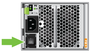

Make sure that the circuit breakers located on the rear left and right side power supplies of the Oracle ZFS Storage Appliance ZS7-2 are in the ON (|) position.
Figure 5.4 Oracle ZFS Storage Appliance ZS7-2 Circuit Breakers

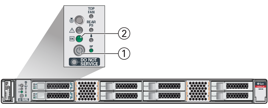

Press the Power button located on the front of the first (bottom) management node. See Figure 5.5.
The first management node is located in rack unit 5 (U5). The second management node is located in rack unit 6 (U6). It is switched on and configured automatically during the initial power-on sequence.
A management nodes take approximately five to ten minutes to power on completely. Once complete, the Power/OK LED illuminates and remains a steady green.
Figure 5.5 Oracle Private Cloud Appliance Management Node
Table 5.2 Figure LegendItem
Description
1
Power button
2
Power/OK LED
After powering on the first management node, wait while the second management node and all compute nodes are powered on and discovered.

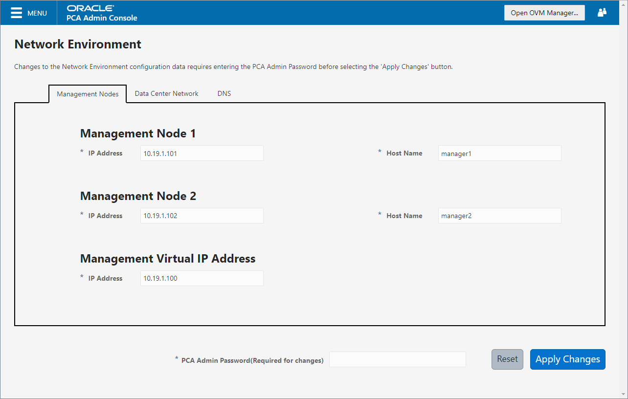

Go to the Network Environment window and enter the configuration details. Insert the reserved management node IP addresses and environment parameters of your data center network.
In the Management Nodes tab, enter the IP addresses and host names for both management nodes.
NoteDuring the initial configuration of the Oracle Private Cloud Appliance, you change the predefined configuration IP address to the reserved virtual IP address in your data center network. For details, see Section 3.3, “General Network Configuration”.
Figure 5.6 Management Nodes Tab

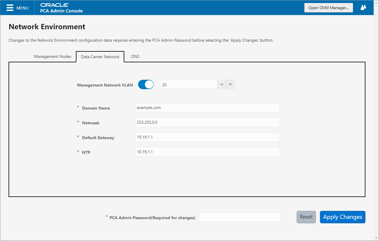

In the Data Center Network tab, enter the domain name, netmask, default gateway and NTP server of the network to which the appliance must be connected. If this network is a VLAN, set the slider to active and enter the VLAN ID in the field next to it.
Figure 5.7 Data Center Network Tab

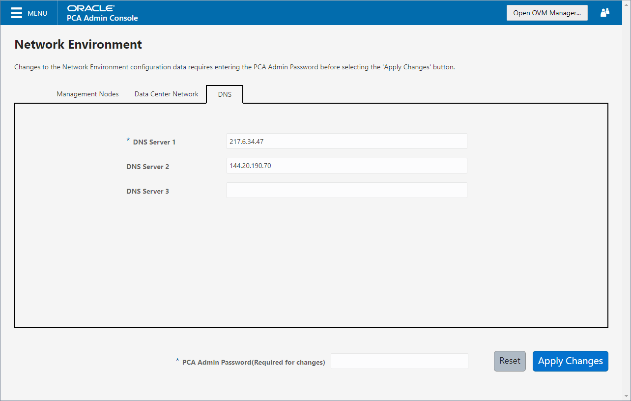

In the DNS tab, enter at least one and up to three name servers for the network to which the appliance must be connected.
Figure 5.8 DNS Tab
