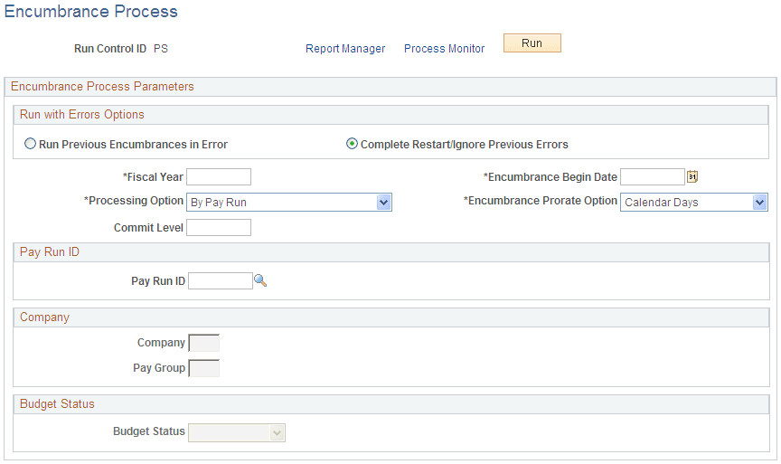

Encumbrance Process Page
Use the Encumbrance Process page (HP_RUN_CNTL_ENC) to run the Batch Encumbrance Calculation process (ENC_CALC) to calculate pre-encumbrances and encumbrances in batch, either to create baseline data for a new fiscal year or to calculate updates to the baseline data.
Navigation:
Set Up HCM, and then Product Related, and then Commitment Accounting, and then Process Encumbrances, and then Encumbrance Process
This example illustrates the fields and controls on the Encumbrance Process page.
After running fiscal year encumbrances, run the Encumbrance GL Interface process (PAYGL03) to post the encumbrances.
Run With Errors Options
Field or Control Description
Run Previous Encumbrances in Error
Select to restart a previous process that contained errors. The system reprocesses only those records containing errors. Use this option after you have addressed the errors from the previous run.
When you select this option, the system populates the rest of the fields on the page with the settings from the instance that you are reprocessing, and all fields become read-only.
Complete Restart/Ignore Previous Errors
Select this option if you want to restart the Batch Encumbrance Calculation process and ignore errors from previous runs. When you select this option, you select processing settings using the rest of the fields on this page.
Additional Encumbrance Process Parameters
Fiscal Year
Enter the fiscal year for which you want to create pre-encumbrance and encumbrance transactions.
Encumbrances and pre-encumbrances can extend into subsequent fiscal years when they are associated with a funding end date that is after the end of the specified fiscal year. However, if the Batch Encumbrance Calculation process finds existing encumbrances for subsequent fiscal years, it will not create encumbrances for these subsequent fiscal years.
Encumbrance Begin Date
Enter the date that you want the system to start calculating encumbrances. For example, if your fiscal year runs from April 1 to March 31, and you specify May 1 as the Encumbrance Begin Date, the encumbrance calculations are prorated to 335 days (rather than 365).
When you create baseline encumbrances, the Encumbrance Begin Date is generally the same as the Fiscal Year Begin Date.
However, if you need to recalculate the encumbrance after you have confirmed one or more pay cycles for the fiscal year, the system will determine the encumbrance begin date. This date is the greater of either the last pay confirm date plus one day or the encumbrance begin date entered in the run control.
Encumbrance Prorate Option
If you are prorating encumbrances across accounting periods, you can prorate using calendar or work days. Indicate if the encumbrance prorate option is Calendar Days or Work Days.
Processing Option
Select from the following options:
  • By Budget Status: create baseline encumbrance transactions based on budget status.
  • By Company / Paygroup: create baseline encumbrance transactions for departments in a company that you select.
  • By Pay Run: create encumbrances for all pay groups that are attached to the specified Pay Run ID.
  • By Table Change: update baseline encumbrance transactions based on encumbrance triggers generated by setup table changes.
Pay Run ID
Pay Run ID
If your processing option is Pay Run, enter a specific pay run ID here.
Company
Company and Pay Group
If your processing option is Company, enter a specific company here. To further limit processing to a specific pay group, select a pay group as well.
Note: When processing pre-encumbrances, the entire company is processed regardless of the specified pay group.
Budget Status
Budget Status
If your processing option is Budget, the system processes the employees or positions with the budget check status you select. The options are Invalid or Pending.
