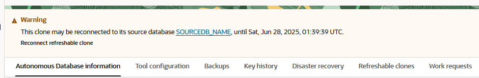

Refreshable Clone Reconnect to the Source Database
After you perform a Disconnect refreshable clone operation, a banner displays the date and time up to which you can reconnect the database to the source. The banner also includes a Reconnect refreshable clone button.
When a disconnected database is not reconnected within 24 hours from the disconnect time, the Oracle Cloud Infrastructure Console removes the reconnect refreshable clone banner.
