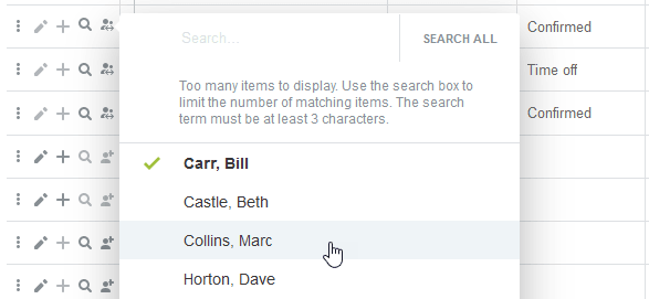

To change the resource for all the bookings on a booking row, click the Change Resource icon
, then select a named resource or a generic resource from the dropdown list. You can use the search bar to refine the dropdown list as you type.
You can distinguish between a named resource or a generic resource with different icons. A solid resource icon
indicates a named resource, an outline resource icon
indicates a generic resource. -
