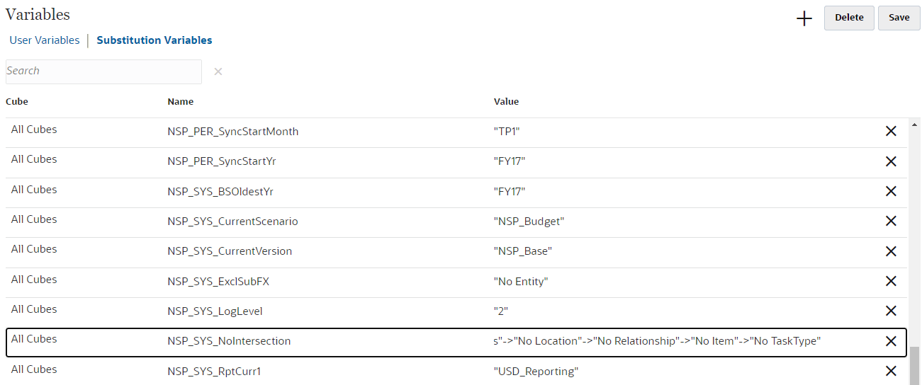

The following screenshot shows "No TaskType" added to the NSP_SYS_NoIntersection substitution variable:
