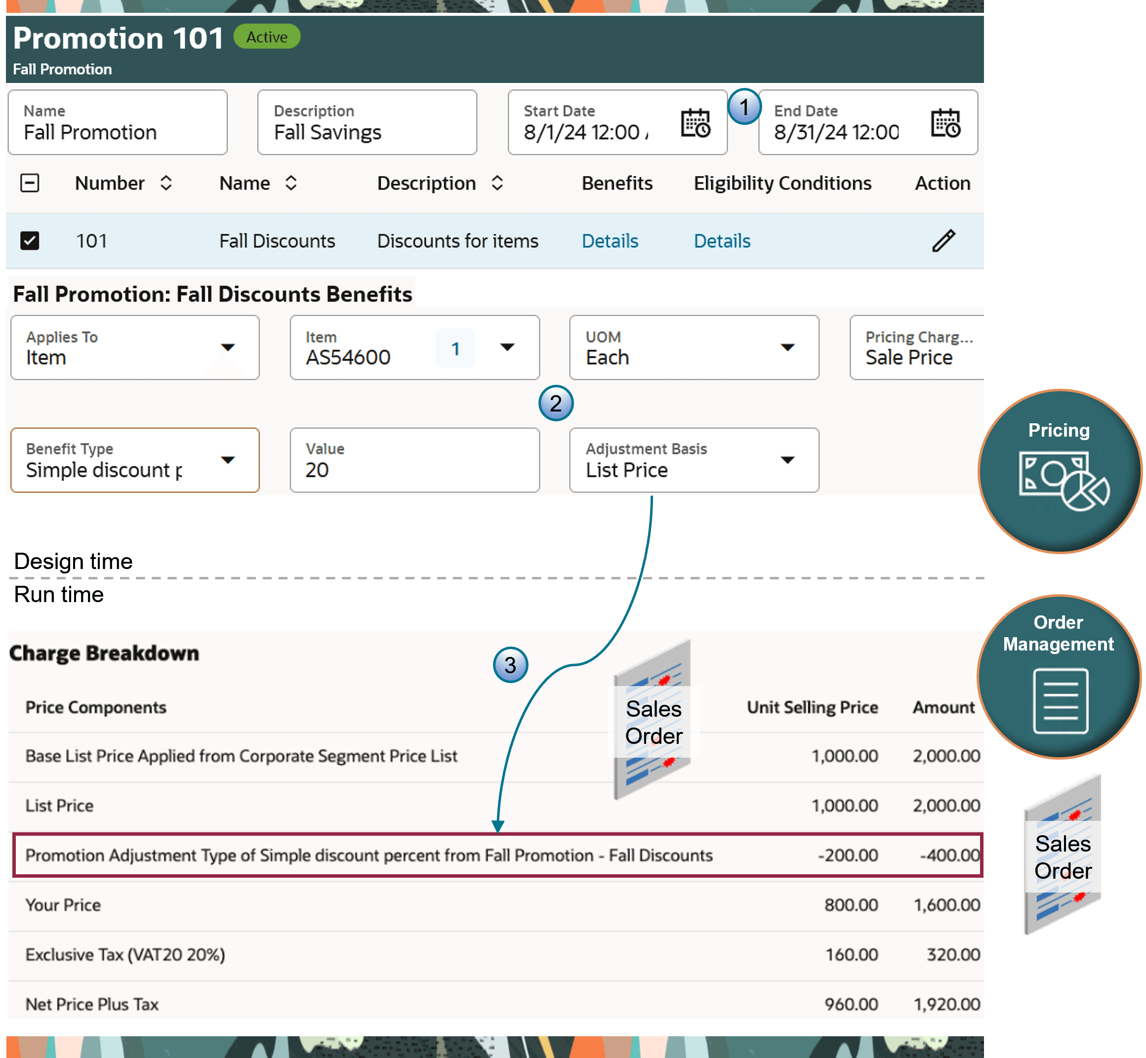

Create a Simple Promotion
Assume you sell supplies and equipment to students of all ages. You have a fall promotion that you want to run during the entire month of August:
Apply a 20% discount
off the list price of each AS54600 item that my customer buys on August 1, 2024
through August 31, 2024.
Here's your set up:
Try It:
- Go to the Pricing Administration work area, then click Pricing Promotions.
- On the Pricing Promotions page, click Create Promotion,
then set the values:
Attribute Value Number 101
Note
- You can enter any alphanumeric value.
- The value must be unique across promotions.
- If you don't provide a value, then Pricing will automatically assign one after you save your work.
- You can't change the number after you save.
- The same behavior applies for a promotion line's number.
Name Fall Promotion Description Fall Savings Start Date August 1, 2024
Use the promotion's start date and end date to determine when you want the promotion to be in effect.
End Date August 31, 2024 - Click Add Row to add a promotion line, set the values,
then click Apply:
Attribute Value Promotion Line Number 101 Promotion Line Name Fall Discounts Promotion Line Description Discounts for items -
A benefit is an incentive that provides a reason to motivate your customer to purchase an item. Click Add in the Benefits column, then set the values:
Attribute Value Applies To Item Item AS54600 UOM Each Pricing Charge Definition Sale Price
Use this attribute to identify the charge where you want to apply the promotion.
Assume you select Sale Price. If the item on the order line has a sale price charge, then Pricing will apply the promotion on that charge.
For this example, you select only Sale Price, so Pricing will apply the promotion only on the sale price.
Benefit Type Simple Discount Percent Value 20 Adjustment Basis List Price - Click Activate to make the promotion available so Pricing
can use it to price your sales order. Use this button to help manage your set
up. For example, you might need to add a number of lines and conditions before
you want Pricing to use this promotion.
You can't deactivate or delete a promotion. If you no longer want Pricing to use it, then set the End Date to a date that has already occurred.
If the sales order meets the condition, then Pricing will apply the rule at run time on the sales order in Order Management. The charge breakdown on the order line will include the promotion name, the promotion line's name, the type of adjustment, and the adjustment amount:
Promotion Adjustment Type of Simple
Discount Percent from Fall Promotion – Fall Discounts

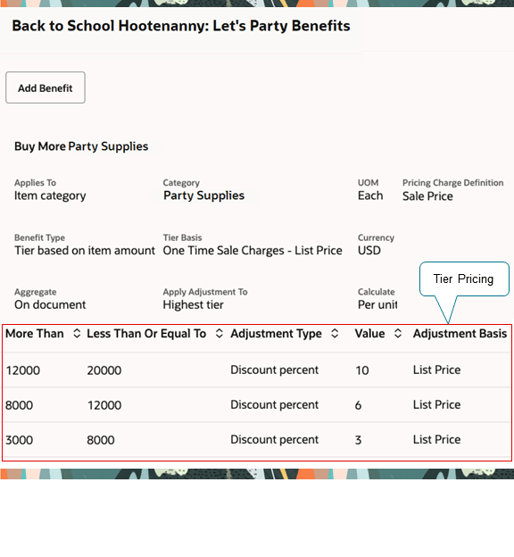

Tier Your Adjustments
You can add a tiered discount according to the list price and the category that the item is in:
If the total amount of one time charges for all party supplies on the sales order is more than:
- $12,000 but less than $20,000, then apply a 10% discount off the list price.
- $8,000 but less than $12,000, then apply a 6% discount off the list price.
- $3,000 but less than $8,000, then apply a 3% discount off the list price.
Tell Pricing how to calculate the rule:
| Attribute | Value |
| Calculate |
You can set it to one of:
For this example, set it to Per Unit. |
For background about tier pricing and how to set some of these attributes, see Tier Pricing and Add Tiers to Pricing Rules.

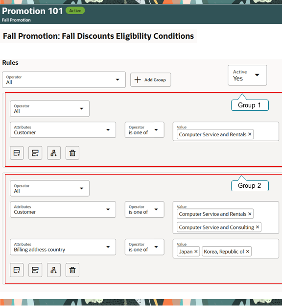

Use Eligibility Conditions to Focus Your Promotion
Assume this rule is too broad for your needs:
Apply a 20% discount off the list price of each AS54600
item that my customers buy on August 1, 2024 through August 31,
2024
You can use a set of predefined customer attributes, order line attributes, and item attributes to focus your rule according to those attribute's values.
Consider this example:
Adding a group adds OR logic to your eligibility conditions. The Rules section in this example has two groups:
| Group | Rule |
| 1 | If the Customer attribute contains Computer Service and Rentals, then apply the promotion. |
| 2 | Or if the Customer attribute contains Computer Service and Rentals, or if it contains Computer Service and Consulting, and if the billing address is in Japan or Korea, then apply the promotion. |
Note
- If you reference an attribute that might have more than one value, such as Billing Address City, then include another condition that examines a different attribute, such as Billing Address State or Billing Address Country. This will help to further qualify the promotion.
- The Eligibility Conditions dialog displays the attribute values that you can set.

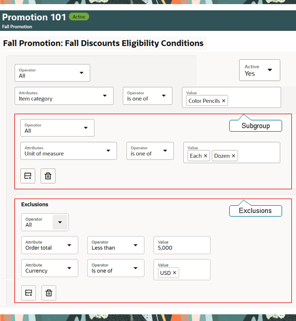

Group and Exclude
Use subgroups and exclusions to focus your promotion even more. A subgroup works like adding an AND operator to the group, while an exclusion works like adding a NOT operator to the group. Consider this example:
The category specifies Color Pencils as the group, an order line attribute specifies the subgroup, and we also have an exclusion. The example applies this rule:
| Condition | Rule |
| Group | If the item is in the Color Pencils category. . . |
| Subgroup | . . . And if the order line's Unit of Measure attribute contains Each or it contains Dozen. . . |
| Exclusion | . . . And if the total amount on the sales order isn't less than 5,000 and the currency is USD, then apply the promotion. |
Note
- If you specify a condition according to Line Amount or Order Total, then include the currency as a separate condition.
- If you specify a condition according to Line Quantity, then include the UOM as a separate condition.
- Some customer attributes might have more than one value, such as Billing Address City. If you reference an attribute that might have more than one value, then include another condition, such as Billing Address State or Billing Address Country. This will help to further qualify the promotion.
- You can use the Is One Of operator to specify more than one value in a condition. This example's subgroup uses the Is One Of operator to apply the condition when the attribute's value is Each or Dozen.
