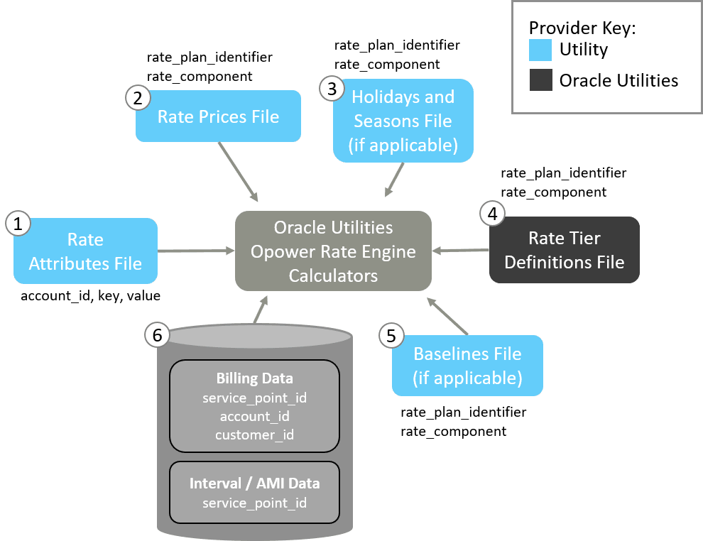

Tiered Rate Plan
In a tiered rate plan, customers are charged based on how much
energy they use within certain tiers. For example, residential
electricity customers could be charged one rate for the first 100
kWhs they consume in a bill period, a higher rate for the next 30
kWhs, and a higher rate for the next 70 kWhs. The graphic below
shows the files and data fields involved in a tiered rate plan,
along with who must provide each file. The
rate_plan_identifier and rate_component
fields form the common link between most of the files.
1. Rate Attributes File
The Rate Attributes file identifies the account_id of customers and
the rate plan attributes that each account is associated with. For example, as shown below, a
key could be RATE_PLAN_CODE and a value could be E-RES to
associate a customer account with a residential electricity rate plan. Additionally, other
key-value pairs can be used to associate a customer's account with different rates based on
their geographic location, such as whether they live inside or outside city limits. See Rate Attributes File for more information and additional examples, including
for solar customers.

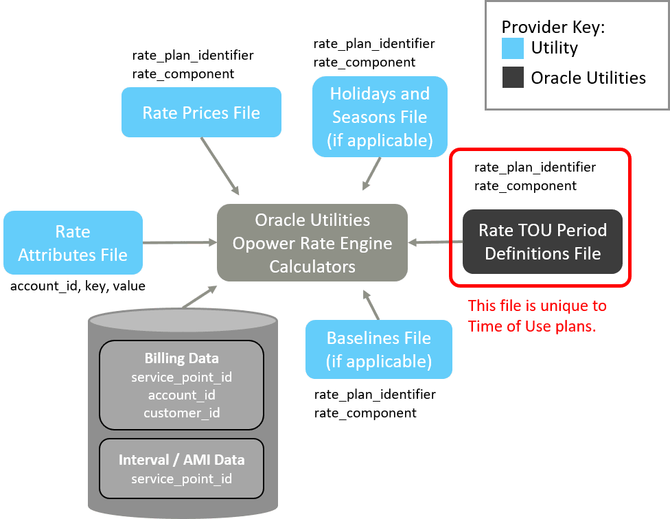

Time of Use Rate Plan
In a time of use (TOU) rate plan, customers are charged based on the time of day when energy is used. TOU insights can be shown in various Oracle Utilities Opower products and features such as the High Bill Alert AMI communication and the Load Shifting Time of Use 101 module.
For this type of rate plan, most of the same files as in a tiered rate plan are applicable. See the tiered rate plan example above for descriptions and examples of each file. However, a TOU plan has one primary difference: a TOU period definitions file is required instead of a tier definitions file.
The Rate TOU Period Definitions file specifies each time period in the day when the cost of energy varies. For example, as shown in the table below, the file can specify the peak, partial peak, and off-peak time periods for different seasons of the year, days of the week, and even holidays. See Rate Period Definitions File for more information and additional examples.
