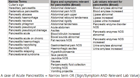

Standardized MedDRA Queries (SMQs) are designed to aid in the identification and retrieval of case safety reports in clinical studies. The MedDRA Maintenance and Support Services Organization (MSSO) defines SMQs as follows:
SMQs are groupings of terms from one or more MedDRA System Organ Classes (SOCs) that relate to a defined medical condition or area of interest. They are intended to aid in case identification. The included terms may relate to signs, symptoms, diagnoses, syndromes, physical findings, laboratory and other physiologic test data, etc., related to the medical condition or area of interest. Lowest Level Terms (LLTs) that are not subordinate to an included Preferred Term (PT) are excluded.
See the figure below for an example of a MedDRA SMQ.
TMS provides filter dictionaries as a generic way to support SMQs and potential similar features for other standard dictionaries. You define, load, and maintain a filter dictionary in the same way you define, load, and maintain a base dictionary such as MedDRA. You must define a filter dictionary as a strong dictionary with at least one level and link the filter dictionary to one and only one base dictionary. In addition, before you load MedDRA SMQs you must define broad and narrow named relations and algorithm Informative Notes (see below).
MedDRA SMQs may use one or more of the following design features:
- Broad and Narrow. SMQ relations with dictionary terms may be identified as
broad or narrow. Narrow terms are
highly likely to represent the condition of interest
while broad terms help to identify all possible
cases, including some that may prove to be of little
or no interest. A broad search retrieves broad
terms. A narrow search retrieves narrow terms.
To support broad and narrow SMQ searches in TMS, define and load broad and narrow named relations from SMQ terms to base dictionary terms.
- Algorithm. Algorithms within SMQs are used to further define combinations of
specific terms based on rules defined in an
algorithm that can be processed programmatically
during a search operation.
To support SMQ algorithms, define an Informative Note of type Algorithm for SMQ terms with algorithms; see Defining Informative Notes for SMQ Algorithms.
MSSO provides predefined categories of terms called A…F. You must load these categories with SMQ filter dictionary terms and store them in the Status column of the table TMS_DICT_RELATIONS. Some SMQ algorithms use these categories.
- Hierarchy. Some SMQs are a series of queries related to one another in a
hierarchical relationship similar to the
hierarchical structure of MedDRA itself.
To support hierarchical SMQ searches in TMS, load SMQ terms into different levels of the filter dictionary with relations between the terms.
Figure 6-1 Figure 6-1 Acute Pancreatitis SMQ Terms and Algorithm
