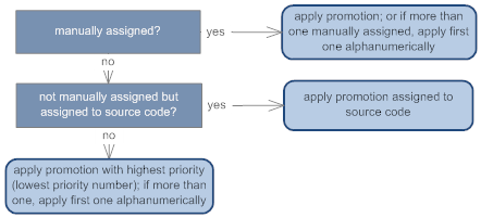

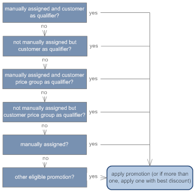

How does an order qualify? You can set up an order, freight, or additional freight promotion that will apply to every order you take; to do so, do not complete any of the qualifying fields for the promotion. The promotion can apply to the order as long as the current date falls within the date range specified for the promotion.
Use once?
For the other promotion types, or if you want to restrict an order, freight, or additional freight promotion to only certain orders, your selection criteria can include:
- source code (used on order header) or offer (associated with the source code used on the order header). You can also exclude source codes from a promotion by selecting the Exclude promotions field for the source code. Typically, you would exclude a source code from promotions when you have set up a promotion that specifies an offer, and you want to include most of the source codes associated with that offer except for a few.
- pay type (even if this pay type is not the only one on the order)
- merchandise total
- total item quantity (minimum or maximum)
- shipping location, such as restricting a freight or additional freight promotion to a range of SCF codes or to the continental U.S.A. (freight or additional freight promotions only)
- customer or customer price group
- order history (including first-time buyers who have never placed an order, or never received an order shipment)
- item categories
- ship via priority
Important:
The system evaluates promotion qualifiers on an “all or nothing” basis; in other words, if you set up a promotion to qualify based on source code, pay type, and merchandise total, and an order does not match all of these qualifiers, none of the discounts or overrides of the promotion will apply to the order. To apply the promotion to any order matching either the source code, pay type, or merchandise total, set up a separate promotion for each.See the Cautions Related to Promotions.

Promotion Hierarchy: Best Way
Best way promotion hierarchy: The Best Way Promotions (K44) system control value indicates whether to try to apply the promotion of each type (with the exception of BOGO promotions; see Best Way Promotion Hierarchy for BOGO Promotions specifically called out for the order or customer, or that provides the highest discount. With this system control value selected, the system uses three basic criteria:
- Manual entry? Manually-entered promotions (entered at the Enter Promotion Code Screen or passed in the inbound order message) are preferred over system-assigned promotions (applied automatically because the order is eligible and the Required entry flag is unselected). However, if the Allow Manual Entry of Promotion Code (I63) system control value is unselected, it is not possible to manually enter a promotion code.
- Customer or customer price group assignment? When you specify a customer price group for a promotion, the system prefers this promotion to those without a customer price group assignment. However, when you specify a particular customer number for a promotion, this gives the promotion higher priority than promotions with just a customer price group promotion.
- Best savings? If a promotion is not differentiated through manual entry, customer assignment, or customer price group assignment, the system selects the promotion of each type that provides the highest total discount dollar value. In the case of a freight promotion, a ship via override is determined to be the best value.
As a result, the system selects among eligible promotions using the hierarchy illustrated below:
If the Allow Manual Entry of Promotion Code (I63) system control value is unselected, manual entry of a promotion is not possible, so the hierarchy is simpler:
- Customer qualifier? Is the customer specified at the Work with Qualifying Customer/Price Groups Screen?
- Customer price group qualifier? Is the customer assigned to a customer price group specified at the Work with Qualifying Customer/Price Groups Screen?
- Best savings? If the customer does not qualify based on customer number or price group, or if the system must select among more than one promotion with the same qualifier, it selects the promotion of each type that provides the highest total discount dollar value.
Examples of best discount calculation:
- Tiered promotion TA offers 10% off an order with a total merchandise value of $100.00, for a total discount of $10.00. Tiered promotion TB offers a free item; the item’s regular price is $15.00. Promotion TB provides the best discount ($15.00 is more than $10.00).
- Item category promotion IA offers 15% off a minimum order of $25.00. Item category promotion IB offers a special item category price of $1.99. The order includes 12 units of qualifying items at $2.50 each for a total merchandise value of $30.00 in the category. Promotion IB ($1.99 * 12, or $23.88, for a total savings of $6.12) offers a better discount than promotion IA (15% of $30.00, or $4.50).

Promotion Hierarchy: Regular Priority
When the Best Way Promotions (K44) system control value is unselected, the system does not check whether the promotion is assigned to a particular customer number or customer type, or whether it offers the best discount. Instead, it uses two different possible hierarchies, depending on the setting of the Allow Manual Entry of Promotion Code (I63) system control value:
If the Allow Manual Entry of Promotion Code (I63) system control value is selected:
| # | Step |
1. |
Promotion assigned to source code: Is there a promotion of this type assigned to the source code on the order header? If the order qualifies for the promotion you have defined in the Source Code table, this promotion applies to the order. Also, if the promotion is flagged for Required entry, it must be entered on the order or passed in the order API; otherwise... |
2. |
Manually entered: If there is no promotion assigned to the source code, look first to promotions that are manually entered at the Enter Promotion Code Screen or passed in the order API. If more than one promotion of the same type is manually entered or passed in the order API, select the promotion based on the:
3. |
System-assigned: If there is no promotion of the type manually entered or passed in the order API, look for eligible promotions that are not flagged for Required entry. If there is more than one, select the promotion based on the:
If the Allow Manual Entry of Promotion Code (I63) system control value is unselected:
| Example # | Description |
1. |
Promotion assigned to source code: Is there a promotion of this type assigned to the source code on the order header? If the order qualifies for the promotion you have defined in the Source Code table (and not flagged for Required entry), this promotion applies to the order. Otherwise... |
2. |
System-assigned: If there is no promotion of the type assigned to the source code, look for eligible promotions that are not flagged for Required entry. If there is more than one, select the promotion based on the:
