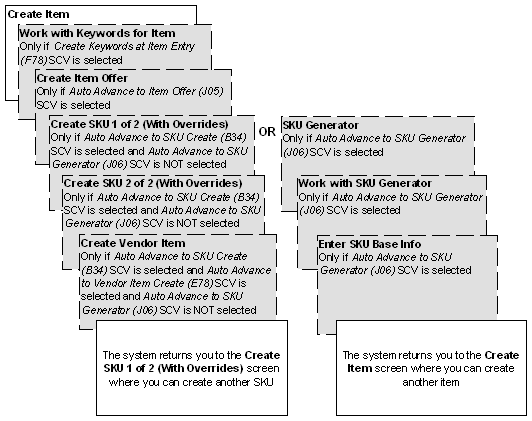

Non-SKUed item screen flow: The system automatically advances you through the following screens if the item you are copying is a non-SKUed item.
- Create Item Screen. The information on this screen defaults from the copied item; however, you can change any value.
- Create Item (Base Information) Screen. The information on this screen defaults from the copied item; however, you can change any value.
- Create Vendor Item Screen (only if the Auto Advance to Vendor Item Create (E78) system control value is selected). The information on this screen does not default from the copied item.
- First Work with Keywords for Item Screen (only if the Create Keywords at Item Entry (F78) system control value is selected). The information on this screen does not default from the copied item.
- Create Item Offer Screen (only if the Auto Advance to Item Offer (J05) system control value is selected). The information on this screen does not default from the copied item.
Once you have completed creating the item, based on copied item information, the system returns you to the Work with Items Screen.
SKUed item screen flow: The system automatically advances you through the following screens if the item you are copying is a SKUed item.
Once you have completed creating the item, the system returns you to the Work with Items Screen. Every SKU defined for the copied item is automatically created for the new item.

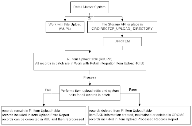

Copy Item to Company Window
Purpose: Use this window to create an item upload record in the RI Item Upload Table (RIIUPP) in order to add or change item information for an item with the same item number as the copied item in each shared company.
Once the system creates the item upload record, the system follows the regular RI Item Upload Process to process the record. If the record contains errors, the system places the record in the Working with Retail Integration Item Upload (RIIU) menu option in the shared company where you can review, correct, and reprocess the record.
Copy Item to Company allows you to maintain inventory in the parent company and copy the item information over to your shared companies.
Example:
- When you create item A1 in the parent company, you can copy A1, including its offers, prices, UPC, coordinates, and vendor items, over to the shared companies.
- When you change item A1 in the parent company, you can copy the item updates to item A1 in the shared companies.
How to display this screen: Select Copy to Company for an item at the Work with Items Screen.
When you select this option:
- An error message indicates if you do not have authority to the Copy Item to Company Security (B15) secured feature: Not authorized to Copy.
- An error message indicates if shared companies do not exist for the current company: Shared companies do not exist for the parent. You can define shared companies for a company in Working with Companies (WCMP).
The system defaults the settings selected the last time the window was accessed; however, you can change the settings.
| Field | Description |
| From company |
A code for the company where the copied item is located. This represents a parent company that is associated with one or more shared companies. Numeric, 3 positions; display-only. |
| From item |
The item number and description of the copied item. Item number: Alphanumeric, 12 positions; display-only. Item description: Alphanumeric, 120 positions; display-only. |
| Action to perform |
Indicates the type of item upload record you wish to create in the RI Item Upload Table (RIIUPP).
Alphanumeric, 1 position; required. |
| Select record types You must specify the type of item information you wish to populate in the item upload record, using the item information defined for the copied item, by selecting at least one of the following fields. For each record type selected, the system copies the item information from the copied item and creates an item upload record for each shared company. If you do not select at least one of the record type fields, an error message indicates: At least one record type required. Example: If you wish to create the copied item in each shared company, enter A in the Action to perform field and select each Record type field. The system will copy all item information for the copied item and create the item in each shared company. Note: The system does not validate that the record type you select to copy exists for the copied item. If the selected item information does not exist, the system submits the Copy Item to Company process, but does not create an item upload record for that record type. |
| Item/SKU |
Indicates whether the system creates an item upload record for record type 01 (item/SKU) in the RI Item Upload Table (RIIUPP) for each shared company, using the item/SKU information defined for the copied item.
| Item offer |
Indicates whether the system creates an item upload record for record type 03 (item offer) in the RI Item Upload Table (RIIUPP) for each shared company, using the item offer information defined for the copied item.
| SKU offer |
Indicates whether the system creates an item upload record for record type 04 (SKU offer) in the RI Item Upload Table (RIIUPP) for each shared company, using the SKU offer information defined for the copied item.
| Item price |
Indicates whether the system creates an item upload record for record type 05 (item price) in the RI Item Upload Table (RIIUPP) for each shared company, using the item price information defined for the copied item.
| SKU price |
Indicates whether the system creates an item upload record for record type 06 (SKU price) in the RI Item Upload Table (RIIUPP) for each shared company, using the SKU price information defined for the copied item.
| Item UPC |
Indicates whether the system creates an item upload record for record type 08 (item UPC) in the RI Item Upload Table (RIIUPP) for each shared company, using the item UPC information defined for the copied item.
| Item coordinate |
Indicates whether the system creates an item upload record for record type 09 (item coordinate) in the RI Item Upload Table (RIIUPP) for each shared company, using the item coordinate information defined for the copied item.
| Vendor item |
Indicates whether the system creates an item upload record for record type 07 (vendor item) in the RI Item Upload Table (RIIUPP) for each shared company, using the vendor item information defined for the copied item.
| Shared companies |
The shared companies for which the system will create an item upload record, based on the action code and record types selected. Up to 10 shared companies display in company number sequence. A plus sign (+) indicates if more shared companies exist. You can select Shared Comp to view a complete list of the shared companies for which an item upload record will be created. Numeric, 3 positions; display-only. |
| Screen Option | Procedure |
Submit the copy item to company process to create item upload records in the RI Item Upload Table (RIIUPP) for each shared company, based on the action code and record types selected |
Select Accept. The system returns you to the Work with Items Screen with a message similar to the following: Copy Item To Company program has been submitted to batch. See Copy Item to Company Process for the steps the system performs. |
Review a list of shared companies for which the system will create an item upload record, based on the action code and record types selected |
Select Shared Comp to advance to the Shared Companies window. Note: You cannot add, change, or delete shared companies at this window. You can define shared companies for a company in Working with Companies (WCMP). |
Instructions: Complete the following steps to create an item upload record in the RI Item Upload Table (RIIUPP) in order to add or change item information for an item with the same item number as the copied item in each shared company, based on the action code and record types selected at the Copy Item to Company Window.
| # | Step |
1. |
In the Action to perform field, indicate the type of item activity you wish to perform.
2. |
Select the record types you wish to create. This represents the item information you wish to create or update, based on the specified action code. See:
3. |
Select Accept. The system returns you to the Work with Items Screen with a message similar to the following: Copy Item To Company program has been submitted to batch. |
4. |
The system creates item upload records in the RI Item Upload Table (RIIUPP), based on the action code and record types selected. Each item upload record is created with:
5. |
Once the Copy Item to Company program has created all of the item upload records, the system automatically submits the RI Item Upload process to process the records in the RI Item Upload Table (RIIUPP). See RI Item Upload Process for processing details. Note: If item upload records already exist in the RI Item Upload table, the system processes those records along with the records created through the Copy Item to Company program. |
6. |
The system creates supporting table values for items/SKUs through the item upload if the value does not exist in the shared company. For example, if the buyer code does not exist in the shared company, the system creates it. See Tables Updated by the RI Item Upload for a list of the tables for which the RI Item Upload process will create new records. |
9. |
The system places any records that contain errors in an error status in the RI Item Upload Table (RIIUPP) and Retail Integration Item Upload Error table. You can review the records in error on the Item Upload Error Report and on the Work with Retail Item Upload Errors Screen in Working with Retail Integration Item Upload (RIIU). See Retail Item Upload Errors for a list of errors that may occur. Note: Item upload records in error are listed in the Work with Retail Integration Item Upload (RIIU) menu option in the shared company, not the company where the copied item is located. For example, if you create the copied item in shared companies 100 and 200 and both item upload records error, you must review and correct the item upload record in error in each shared company (companies 100 and 200). |
10. |
Once the Item Upload process completes, the system generates the following reports:
Item Upload Records Created
The table below indicates the type of item upload record created, based on the action code and record type selected.
| Action / Record type | Item Upload Record Created |
| Item upload records created for record type Item/SKU | |
A Item/SKU |
The item upload record contains:
Note: If the item already exists in the shared company, the system automatically changes the Request type to C (maintain).Short SKU: The system generates a new short SKU code for each item/SKU created in the shared company. Long SKU department and long SKU division: The system creates the long SKU department in the shared company if it does not already exist. In addition, if a long SKU division is defined for the long SKU department being created, the system also creates the long SKU division in the shared company. However, if the long SKU department does not need to be created, the system will not create the long SKU division in the shared company if it does not already exist. Cost: The system copies the cost defined. |
**DFLT ITEM: If a field for the copied item is blank, the system creates the item upload record and leaves the field blank. However, if the **DFLT ITEM Item/SKU exists as an item in the shared company, the system defaults the value defined for the **DFLT ITEM item to the blank field in the RI Item Upload record. For example, if the buyer code is blank from the copied item, but the **DFTL ITEM contains buyer code BTM, the system defaults BTM to the item upload record and creates the item in the shared company with buyer code BTM. See **DFLT ITEM Item/SKU for more information on setting up this item. Item Upload Processing Results: The system creates an item/SKU in each shared company, using the item number and item/SKU information from the copied item. If the copied item contains SKUs, the system creates a SKU for each SKU defined for the copied item. |
C Item/SKU |
Short SKU: The system retains the short SKU defined for the item in the shared company instead of updating the short SKU with the short SKU defined for the copied item. Long SKU department and long SKU division: The system creates the long SKU department in the shared company if it does not already exist. In addition, if a long SKU division is defined for the long SKU department being created, the system also creates the long SKU division in the shared company. However, if the long SKU department does not need to be created, the system will not create the long SKU division in the shared company if it does not already exist. Cost: The system copies the cost defined for the item. **DFLT ITEM item: If a field for the copied item is blank, the system creates the item upload record and leaves the field blank. However, if **DFLT ITEM exists as an item in the shared company, the system defaults the value defined for the **DFLT ITEM item to the blank field in the item upload record. For example, if the buyer code is blank from the copied item, but the **DFTL ITEM contains buyer code BTM, the system defaults BTM to the item upload record and updates the item in the shared company with buyer code BTM. See **DFLT ITEM Item/SKU for more information on setting up this item. |
*DFTCHG item: If *DFTCHG exists as an item in the shared company, the system looks to this item to determine if the item in the shared company should be updated with the information from the copied item.
Example: If the copied item has buyer code TWB and the item in the shared company has buyer code BTM, the system will retain buyer code BTM if the *DFTCHG item has a buyer code defined. However, if the Buyer code field for the *DFTCHG item is blank, the system updates the buyer code for the item in the shared company to TWB. See **DFTCHG Item/SKU for more information on setting up this item. Item Upload Processing Results: In each shared company, the system updates the item/SKU with the same item number as the copied item, using the item/SKU information from the copied item. |
| Item upload records created for record type Item Offer | |
A Item Offer |
Item Upload Processing Results: In each shared company, the system creates item offers for the item with the same item number as the copied item, using the item offers from the copied item. |
C Item Offer |
Item Upload Processing Results: In each shared company, the system updates the item offer(s) for the item with the same item number as the copied item, using the item offer information from the copied item. |
| Item upload records created for record type SKU Offer | |
A SKU Offer |
Note: In order to create an item upload record for Record type 04, the copied item must contain SKUs. If the item is a non-SKUed item, the system automatically deletes the item upload record and displays it on the Record Deleted from RI Item Upload Report.Item Upload Processing Results: In each shared company, the system creates SKU offers for the item with the same item number as the copied item, using the SKU offers from the copied item. |
C SKU Offer |
If the SKU offer does not exist, the system automatically changes the Request type to A (add). Item Upload Processing Results: In each shared company, the system updates the SKU offer(s) for the item with the same item number as the copied item, using the SKU offer information from the copied item. |
| Item upload records created for record type Item Price | |
A Item Price |
Item Upload Processing Results: In each shared company, the system creates item prices for the item with the same item number as the copied item, using the item prices from the copied item. |
C Item Price |
If the item price does not exist, the system automatically changes the Request type to A (add). Item Upload Processing Results: In each shared company, the system updates the item price(s) for the item with the same item number as the copied item, using the item price information from the copied item. |
| Item upload records created for record type SKU Price | |
A SKU Price |
Item Upload Processing Results: In each shared company, the system creates SKU prices for the item with the same item number as the copied item, using the SKU prices from the copied item. |
C SKU Price |
If the SKU price does not exist, the system automatically changes the Request type to A (add). Item Upload Processing Results: In each shared company, the system updates the SKU price(s) for the item with the same item number as the copied item, using the SKU price information from the copied item. |
| Item upload records created for record type Item UPC | |
A Item UPC |
Item Upload Processing Results: In each shared company, the system creates item UPCs for the item with the same item number as the copied item, using the item UPCs from the copied item. |
C Item UPC |
If the item UPC does not exist, the system automatically changes the Request type to A (add). Item Upload Processing Results: In each shared company, the system updates the item UPC(s) for the item with the same item number as the copied item, using the item UPC information from the copied item. |
| Item upload records created for record type Item Coordinate | |
A Item Coordinate |
Item Upload Processing Results: In each shared company, the system creates item coordinates for the item with the same item number as the copied item, using the item coordinates from the copied item. |
C Item Coordinate |
If the item coordinate does not exist, the system automatically changes the Request type to A (add). Item Upload Processing Results: In each shared company, the system updates the item coordinate(s) for the item with the same item number as the copied item, using the item coordinate information from the copied item. |
| Item upload records created for record type Vendor Item | |
A Vendor Item |
Item Upload Processing Results: In each shared company, the system creates vendor items for the item with the same item number as the copied item, using the vendor items from the copied item. |
C Vendor Item |
If the vendor item does not exist, the system automatically changes the Request type to A (add). Item Upload Processing Results: In each shared company, the system updates the vendor item(s) for the item with the same item number as the copied item, using the vendor item information from the copied item. |

Assigning Items/SKUs to Offers
Purpose: By assigning an item or SKU to an offer, you indicate that the item or SKU is available to be sold in a particular offer. An item/SKU can be linked to multiple offers. The information you can define for the item/SKU offer includes the page number where the item/SKU appears, information on the item depiction, whether gift wrapping or special handling are available, and the expected return percentage. You can also define pricing at this level.
Item/offer vs. SKU/offer: If an item has SKUs, you can create an item offer record or SKU offer records. You need to establish SKU offer records only if the information differs for each SKU.
Use Work with Item/SKU Offers to change, delete, display, or create item/SKU offers. Additionally, you can advance to the following functions:
- Item pricing: You can define special reduced prices for the item, based on the quantity ordered or the column assignment.
- Page letter assignment: You can define a catalog page and letter for an item, which order entry operators can enter instead of the item code.
- Alias function: You can use aliases to track sales for an item depending on its placement within the same catalog.
Created through SKU generator? The Automatically Create SKU Offers (J71) system control value indicates whether the SKU generator automatically creates SKU Offers and single-unit SKU Prices based on current or future Item Offers and Item Prices. See that system control value for more information.
In this topic:
- Work with Item Offers Screen
- Work with SKU Offers Screen
- Work with Item Prices Screen (Quantity Price Breaks by Offer)
- Work with Alias Screen
- Work with Accompanying Item Screen
For more information: See Create Item Offer Screen to learn how to create an item (or SKU) offer.

Retail Integration (External System to Order Management System)
Topic in this part: The following topics describe the processes, setup requirements, and functions available to upload item information from your retail system into Order Management System.
- Retail Integration (External System into Order Management System) Overview and Setup explains how you can keep merchandise information at your retail merchandising system in sync with merchandise information in Order Management System.
- Working with Retail Integration Item Upload (RIIU) explains how to upload item information from your retail merchandising system into Order Management System.
- Creating and Maintaining Long SKU Divisions (WLDV) explains how to create and modify long SKU division codes.
Generic retail integration from an external system into Order Management System allows you to keep merchandise information in Order Management System in sync with merchandise information in your external merchandising system. Using this integration, you can provide your customers with a consistent shopping experience across your retail store, catalog, and online channels. You can carry the same merchandise and offer your customers the same merchandise pricing in your retail store, catalog, and online channels. This allows you to maintain the image and service levels customers have come to expect.
RMFCS integration: The item import from Oracle Retail Merchandising Foundation Cloud Service (RMFCS) also creates records in the RI Item Upload table and uses the **DFLT ITEM Item/SKU and **DFTCHG Item/SKU; however, the RMFCS import uses a different set of files to populate the RI Item Upload table, and a different periodic function. See Oracle Retail Merchandising Foundation Cloud Service (RMFCS) and Oracle Retail Pricing Cloud Service (RPCS) Integration for more information.
In this topic:
- Uses for the Generic Retail Integration from an External System into Order Management System
- Item Upload Overview
- Setup for Generic Retail Integration from External System into Order Management System
- Creating Default and Change Item/SKU Upload Values: **DFLT ITEM and **DFTCHG
Using this integration, you can:
- upload new or changed merchandise information located in your retail store to Order Management System, such as:
- item and SKU
- item offer
- SKU offer
- item price
- SKU price
- vendor item
- item UPC
- item and SKU coordinate
- create a hierarchy between a long SKU division, long SKU department, and retail class in Order Management System.
You can use the RI Item Upload Process to create and maintain item and SKU information in Order Management System that corresponds to your retail store merchandise. You can upload items and SKUs, item/SKU offers, item/SKU prices, item/SKU UPC codes, vendor items, and coordinate items, and optionally create many other supporting values using Item Upload Batch Processing.
The Use Retail Integration (H26) system control value determines whether Order Management System changes certain table structures so that it can read records you upload from your retail system. When this system control value is selected, the system:
- uses long SKU class codes from the Retail Class table instead of long SKU class codes from the Long SKU Class table. This allows you to create a hierarchy of retail class within long SKU department. You can link retail classes to a long SKU department in Working with Long SKU Departments (WLSD).
- requires a value in the Long SKU department, Long SKU class (retail class), Long SKU style, and Long SKU subclass fields when you create or maintain a base item.
If you wish to selectively require certain long SKU values, you can select one or more of the following system control values instead of selecting the Use Retail Integration (H26) system control value:
- Require L/S Department (I92)
- Require L/S Class (I93)
- Require L/S Style (I94) (This system control value also validates that the long SKU style code is unique at both the item and SKU level.)

Batch processing overview: This flowchart summarizes the process of passing batch item upload records from a retail system other than RMFCS to Order Management System.
RMFCS integration: See Oracle Retail Merchandising Foundation Cloud Service (RMFCS) and Oracle Retail Pricing Cloud Service (RPCS) Integration for more information on the process of importing item data from RMFCS.
How do you upload retail merchandise information? Use the File Storage API or Work with File Uploads (WUPL) to upload retail merchandise information into the RI Item Upload Table (RIIUPP).
- If you use the File Storage API to upload the generic Retail Integration Item file named RIIUPP into the FILE_STORAGE table in the database, you need to use the UPRITEM Upload Retail Item File (Program name PFR0134, Parameter RIIUPP) periodic function to create records in the RI Item Upload Table (RIIUPP).
- If you use Work with File Uploads (WUPL), the RI Item Upload Table records are created through the upload process.
How do you process records in the RI Item Upload table? Once you have passed item upload records from your retail master system to the RI Item Upload table, you can view all the records in the batch using the Working with Retail Integration Item Upload (RIIU) menu option. In order to process the records in the RI Item Upload table:
- Select Process at the Work with Retail Item Upload Screen.
- Select Accept at the Copy Item to Company Window in Working with Existing Items (MITM).
- Submit the RIUPLD function using the PFR0084 program. See Scheduling Jobs for background.
Records that pass all edits: The system deletes these records from the RI Item Upload table and the requested update (create or maintain) is made in Order Management System.
Records that fail one or more of the edits: The system retains these records in the RI Item Upload table and also creates a record for each RI Item Upload record in error in the RI Item Upload Error table. You can review and correct the errors, or delete the record(s) using Working with Retail Integration Item Upload (RIIU). You can review item upload records in error on the:
- Item Upload Error Report: lists item upload records that are in error.
- Record Deleted from RI Item Upload Report: lists item upload records that you manually deleted at the Work with Retail Item Upload Screen.
Retail Item Upload email: If a valid email is defined in the Email address field for the user that submitted the RI Item Upload Program, the system sends a Retail Item Upload Email to the user’s email address when the job completes indicating whether all records were processed successfully or whether any records contain errors.
For more information: See Working with Retail Integration Item Upload (RIIU).

- Creating Items Screen Flow
- Creating Non-SKU’ed Items Screen Flow
- Creating SKU'ed Items Screen Flow
Select the SKUs field on the Create Item Screen to create a SKU’ed item. The system automatically advances you through the following screens to create a SKU’ed item.
| # | Step |
1. |
2. |
First Work with Keywords for Item Screen (only if the Create Keywords at Item Entry (F78) system control value is selected) |
3. |
Create Item Offer Screen (only if the Auto Advance to Item Offer (J05) system control value is selected) |
4. |
Depending on whether you are using the SKU Generator:
6. |
7. |
Once you have completed creating the item and SKU, you return to the:
- Create SKU 1 of 2 (With Overrides) Screen if you are not using the SKU Generator, where you can create another SKU.
- Create Item Screen if you are using the SKU Generator, where you can create another item.
SKU’ed item screen flow:
Purpose: Use this screen to create a SKU for a SKU’d item.
- You advance to this screen automatically when you create a SKU’d item if the Auto Advance to SKU Create (B34) system control value is selected and the Auto Advance to SKU Generator (J06) system control value is unselected. See Creating SKU'ed Items Screen Flow.
- Select Create at the Work with SKUs Screen.
Completing this screen: Select OK to advance to the Create SKU 2 of 2 (With Overrides) Screen. This screen contains additional SKU attributes, including those related to long SKU and physical dimensions.
After you create a SKU, the system returns you to this screen, allowing you to create another SKU. You can select Exit when you have finished creating all SKUs.
You can also select Exit if you wish to create a SKU’ed item without creating the individual SKUs at this time.
Purpose: Use this screen to enter additional information for a SKU.
The values you enter in the "override" section of the screen override the values you entered for the base item. If you leave any of these fields blank and you have entered values at the base item level, the system uses the base item values. For example, if you leave height, length, and width blank and there is a height, length, or width defined at the base item level, the system uses the values at the base item level.
How to display this screen: Select OK at the Create SKU 1 of 2 (With Overrides) Screen.
Completing this screen: When you select OK at this screen, the system:
- If the Auto Advance to Vendor Item Create (E78) system control value is selected, automatically advances you to the Create Vendor Item Screen.
- If the Auto Advance to Vendor Item Create (E78) system control value is unselected, creates the SKU after validating your entries and highlighting any errors, if necessary.
After you create a SKU, the system returns you to the Create SKU 1 of 2 (With Overrides) Screen, allowing you to create another SKU. You can select Exit when you have finished creating all SKUs.
