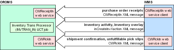

Purchase Order Receipt In API: You can use the Purchase Order Receipt In API to process PO receipts received from another system, such as a warehouse management system. See the Purchase Order Receipt In API for an overview and the required setup.
PO download triggers: The setting of the Create Generic PO Download Trigger for PO Receipt (K27) system control value determines whether the system creates a purchase order download (POH) trigger when a purchase order line is received. See Generic Outbound Purchase Order API for an overview.
For more information see the Web Services Guide on My Oracle Support (ID 2149144.1).

Warehouse Management Integration
In this part: This part includes the following topics:
Warehouse Management System Integration Overview: Provides an overview of the Warehouse Management Integration.
Generic Outbound Purchase Order API: Describes how to send purchase order information to an external system.
Purchase Order Receipt In API: Describes how to process PO receipts received through the generic API.
Generic Pick In API (Shipments, Voids, and Backorders): Describes how to confirm shipments or void pick slips through the generic API.
Warehouse management systems control inventory movement, such as receiving merchandise, inventory transactions, picking and packing, and shipping merchandise to a customer.
The Warehouse Management System integration allows Order Management System and a warehouse management system (WMS) to pass inventory information in order to keep inventory information in both systems accurate. The WMS is where the actual inventory is located, but Order Management System needs to keep track of the changes to inventory that occur in the WMS so that the data in Order Management System remains accurate. For example, if the WMS adjusts the inventory for an item and does not notify Order Management System, orders placed in Order Management System may reserve items that do not have enough inventory in the warehouse.
The warehouse management system integration creates a bridge between Order Management System and a WMS. This bridge allows Order Management System and a WMS to pass data between the two systems using XML messages transmitted via a queue or web service.
In this topic:
What Does Order Management System Send to the Warehouse Management System?
What Does the Warehouse Management System Send to Order Management System?
Order Management System controls item information, vendor information, purchase order information, pick slip information, and return information. Any time you create or modify information in these areas, Order Management System sends the information to the warehouse management system.
The warehouse management system controls changes to inventory, such as purchase order receipts, inventory transactions, and shipping merchandise to customers. Any time the warehouse management system adds or removes inventory in a warehouse, the WMS sends the information to Order Management System.
Warehouse Integration Summary
| Function | Performed By: |
Items: Order Management System sends new or changed items to the warehouse management system (WMS) |
Generic Item Download API For more information see the Web Services Guide on My Oracle Support (ID 2149144.1). |
Vendors: Order Management System sends new or changed vendors to the WMS |
Generic Vendor Download API For more information see the Web Services Guide on My Oracle Support (ID 2149144.1). |
Purchase orders: Order Management System sends new or changed purchase orders to the WMS |
Generic Outbound Purchase Order API For more information see the Web Services Guide on My Oracle Support (ID 2149144.1). |
Purchase order receipts: Order Management System receives information on purchase order receipts sent from the WMS |
Purchase Order Receipt In API For more information see the Web Services Guide on My Oracle Support (ID 2149144.1). |
Inventory activity: Order Management System receives information on inventory activity, such as transfers or adjustments, from the WMS |
Generic Inventory Transaction Upload For more information see the Web Services Guide on My Oracle Support (ID 2149144.1). |
Inventory overlay: Order Management System receives updated inventory information from the WMS |
Pick slip generation: Order Management System sends information on generated pick slips to the WMS |
Generic Pick Out API For more information see the Web Services Guide on My Oracle Support (ID 2149144.1). |
Pick slip void: Order Management System sends information on voided pick slips to the WMS |
Shipment confirmation: Order Management System receives information on full or partial shipments; information on carton contents can also be included |
Generic Pick In API (Shipments, Voids, and Backorders) For more information see the Web Services Guide on My Oracle Support (ID 2149144.1). |
Unfulfillable pick slips: Order Management System receives information on pick slip voids from the WMS |
Returns: Order Management System sends updates on customer returns to the WMS |
NA |
