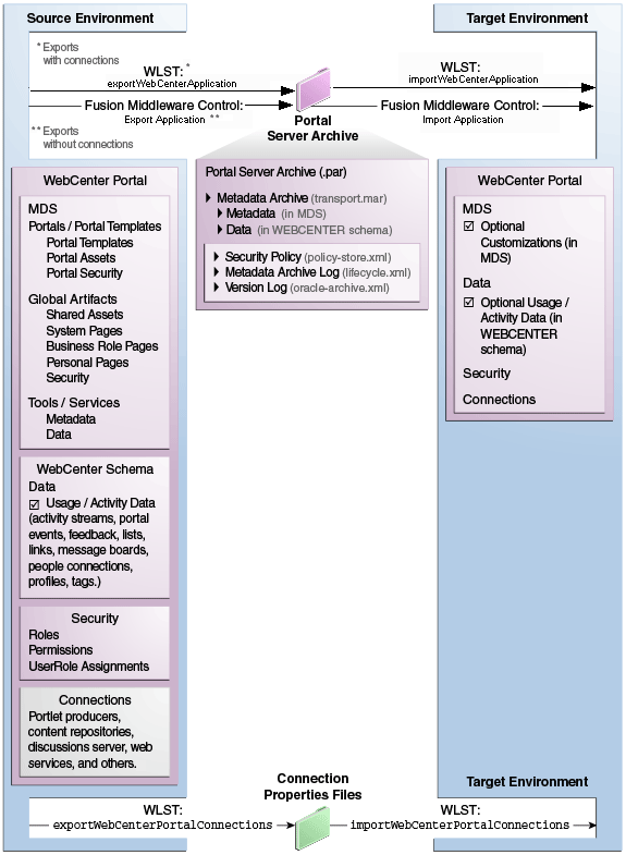

Comparing Back up, Recovery, and Migration Tools for WebCenter Portal
Table 29-1 compares the various tools available to back up and restore WebCenter Portal or migrate WebCenter Portal to another target.
Table 29-1 Backup, Restore, and Migration Tools for WebCenter Portal
| Category | Backup and Restore(Portals and Portal Templates) | Backup and Restore Scripts(Full WebCenter Portal Install) | Migration / Backup(WebCenter Portal Only) |
How to execute |
WLST commands:
Customizable scripts based on:
WLST commands:
Prerequisites |
WebCenter Portal must be installed, fully configured, and running on the target. |
When to use |
Use to back up and restore portals and portal templates. Useful if only one or two portals or portal templates are corrupt. |
Use to restore WebCenter Portal from a nightly/weekly backup that was previously taken using a backup script (in case of corruption).Use to restore configuration in Use to completely restore an entire WebCenter Portal installation on a new machine or WebLogic Server instance that is already installed and configured for Oracle WebCenter Portal. |
Useful in a stage-to-production setup, where the production instance is installed and configured, and you want to copy WebCenter Portal on the stage instance (containing multiple portals, shared assets, security, and so on) to the target for the first time. Suitable for multi-site portals that use a large number of shared assets or other global artifacts that must be moved to the target in a single step. Not recommended for restoring a corrupt WebCenter Portal instance. |
What is backed up / migrated |
Content stored in the portal’s content folder on Content Server, portal pages and assets, and portal data stored in persistence Portal security permissions and roles. For details, see: |
MDS metadata for all tools and services, such as events, portlets, activities, tags, worklists, and so on. Security roles and permissions for all portals and for global artifacts, as well as user-role assignments. Users and audit data are also migrated. Data stored in the WEBCENTER and MDS database schemas. Optionally, data stored in other schemas such as ACTIVITIES, PORTLET, OCS, and so on. |
MDS and data stored in the WEBCENTER schema pages, application integration assets, lightweight content items, and tools and services, such as events, portlets, activities, and tags. Security roles and permissions for all portals and for global artifacts, as well as user role assignments Data stored in the WEBCENTER database schema for activity streams, portal events, feedback, lists, links, message boards, people connections, profiles, surveys, and tags. |
What is not backed up / migrated |
Any content outside of the portal’s content folder on Content Server and any shared libraries used by the portal |
WebCenter Portal domain. |
Data stored on other back-end systems, such as the content server, BPEL server, mail servers, and so on. Application-level settings stored in Credentials (metadata/security/data/credentials). WebCenter Portal domain. |
Pros |
Relatively quick as only specific portals or portal templates are backed up and restored. Allows more granular control over what is backed up and restored. Most efficient when only a few portals are corrupt. |
Simple, extensible, and reliable way to regularly back up data owned by WebCenter Portal. Multiple, granular backup archives generated rather than a single large archive containing everything. |
MDS data, WEBCENTER database data, customizations, and security captured in a single step. Simple to use and quicker than using four separate commands. |
Cons |
Cannot back up content outside of the portal’s content folder on Content Server, any shared library used by the portal, and Home portal. |
Database schemas WEBCENTER and MDS must be restored together. If not, data may become out-of-sync. If restoring additional schemas, such as OCS, you must restore them at the same time and from the same point to maintain data integrity. Incremental backup/restore is not supported. Domain configuration is not included in the backup script so you must back up the domain separately. See Advanced Administration: Backup and Recovery in Administering Oracle Fusion Middleware. Not recommended if you want to restore on a different instance with different back-end servers configured. |
Requires a lot of internal processing. Native tools are not used to extract data from the database. |
Note: Use Fusion Middleware test-to-production scripts to replicate a complete Fusion Middleware instance, installed and configured with WebCenter Portal, WebCenter Content, SOA Suite, BI, and so on, to one or more target environments. These scripts avoid you repeating complex install processes on multiple targets. For details, see Moving from a Test to a Production Environment in Administering Oracle Fusion Middleware.
Test-to-production scripts are not recommended if the source WebCenter Portal installation has been used, that is, the customer has created metadata/data/security.

Understanding Import and Export for WebCenter Portal
Using export and import, system administrators can migrate an entire WebCenter Portal instance between stage and production environments. You can export WebCenter Portal to a single export archive (.par file) using WLST commands or Fusion Middleware Control, as shown in Figure 29-1.
The WebCenter Portal export archive (.par file) contains several files, as listed in Figure 29-1.
Figure 29-1 Migrating WebCenter Portal to Another Target
Information Included in a WebCenter Portal Archive
WebCenter Portal archives can include the following information that is stored in the metadata service (MDS) repository:
Portals and templates- All portals and portal templates
Assets - All shared assets and portal assets
Lightweight content - Images from the all portals’ content folder, styled text, and text.
Pages - All pages, including system pages, business role pages, personal pages, and portal pages
In addition, the WebCenter Portal archive (.par file) can contain:
Tool/service data - Database data associated with those tools and services that store data in the WebCenter Portal schema (WEBCENTER)
Data migration is optional. To migrate data you must set the export option “Include Services Data”.
Security - All roles, permissions, and user role assignments:
application roles (and permissions assigned to each role)
users details and their application role assignments in the Home portal
individual portal members (and their role assignments in each portal)
Information Not Included in WebCenter Portal Archives
The WebCenter Portal archive (.par file) does not include data associated with tools and services that do not store data in MDS or the WebCenter Portal database schema, such as analytics, documents (on content server), mail, calendar events, personalizations, and worklists. To learn how to backup or move data associated with these tools and services, see Backing Up an Entire WebCenter Portal Installation.

Information Always Exported and Imported
The following information is always included when you migrate WebCenter Portal to another target:
Security Policy
policy-store.xml: Application roles and permissions and portal roles and permissions
User role assignments
MDS – Shared / Portal Assets
Page Templates
Navigations
Resource Catalogs
Skins
Page Styles
Content Presenter Templates
Mashup Styles
Data Controls
Task Flows
MDS – Tool/Service Data: Notes
MDS –Tool/Service Metadata
Announcements
Discussions
Documents
Events
Lists (Definitions)
Notes
Mail
Pages
Portlets
Recent Activities
Resource Catalog
RSS News Feeds
Search
Tags
Worklists
MDS – Portal Customizations: Portal administration settings
MDS – User Customizations: Pages, task flows, and preferences
WebCenter Portal Schema – Data
Activity Streams
Portal Events
Feedback
Links
Lists
Message Boards
Profiles
Tags
People Connections: Default settings for profiles, message boards, feedback, connections, activity streams; Activity stream task flow customizations
Information Never Exported and Imported
The following information is never included when you migrate WebCenter Portal to another target:
External - Application Artifacts: icons and images
External – Tool / Service Data
Documents (on content server)
Wikis and Blogs
Activity Graph
Analytics
Mail
Worklists
Out-of-the -box: Portal templates and connections
Note: Connections can be imported or exported based on options. WebCenter Portal export and import can be performed using Fusion Middleware Control or WLST commands. For details, see:

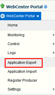

In Fusion Middleware Control, navigate to the home page for WebCenter Portal.
From the WebCenter Portal menu, select Application Export.
Figure 29-2 WebCenter Portal Menu - Application Export Option

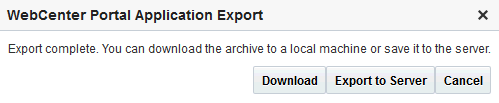

Click Export.
In the Download dialog, click Export to confirm that you want to go ahead.
Figure 29-4 Downloading an Export Archive
Progress information is displayed during the export process. The application being exported cannot be accessed during export operations.
When the export process is complete, specify a location for the export archive (
.par).Figure 29-5 Saving an Export Archive
Select one of:
Download - Saves the export PAR file to your local file system.
Your browser downloads and saves the archive locally. The actual download location depends on your browser set up.

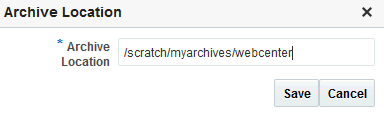

Export to Server - Saves the export PAR file to a server location.
When the Archive Location dialog displays, enter a suitable path for Server Location, for example,
/tmp, and then click Save. The name of the PAR is not required here.Ensure that the server directory you specify has
writepermissions.Figure 29-6 Archive Location
Click Close to dismiss the Export window.

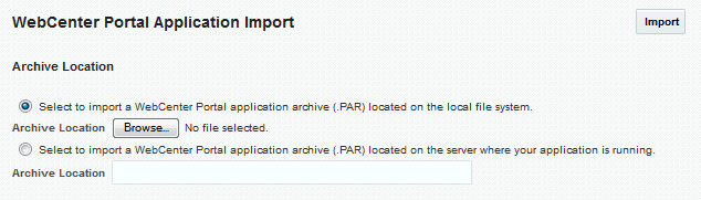

From the WebCenter Portal menu, select Application Import.
In the Application Import page (Figure 29-7), specify the location of your WebCenter Portal archive (
.par).Figure 29-7 Application Import Page
Select one of the following:
Archive Located on Local File System - Enter the Archive Location. Alternatively, click Browse to locate the directory on the local file system where the
.parfile is stored. -
Archive Located on Server File System - Enter the Archive Location. Any shared location accessible from WebCenter Portal.
The archive you select must contain an entire WebCenter Portal export—you cannot import individual portals or portal templates from here. Refer to Importing Portals from an Archive for more information.
Click Import.
In the Application Import dialog (Figure 29-8), click Import.
Figure 29-8 Application Import dialog
Once the import is complete, a success message displays.
After importing an entire WebCenter Portal instance, log in to WebCenter Portal and verify the imported content. For details, see Verifying WebCenter Portal After Import.
