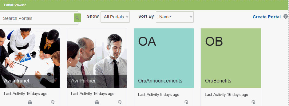

WebCenter Portal provides two portal task flows that you can add to a page:

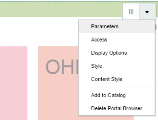

The Portal Browser task flow has associated properties, which users with sufficient privileges can access through the task flow’s View Actions menu. For example, select Parameters to display the Parameters dialog.

In the page editor, the View Actions menu in the toolbar of the Portal Browser task flow provides access to the properties dialogs: Parameters, Access, Display Options, Style, and Content Style.
Figure: Portal Browser Component Toolbar: View Actions Menu
Description of image follows

  2. In the Portal Browser component toolbar, click the View Actions menu and select the properties you want to set:
    • Parameters control the default task flow content. For descriptions of each parameter, see Portal Browser Task Flow Parameters. Parameters can be wired to events, and can be used facilitate the wiring of the task flow to page parameters and page definition variables. See Wiring Pages and Components.
    • Access settings show or hide the component to specific roles, users, or groups. See Setting Component Access.
    • The Display Options, Style, and Content Style properties affect the appearance and behavior of the task flow for all users. These properties are common to all task flows. See Modifying Component Properties.

Specifies the type of layout in which to display portals in the Portal Browser.
  • Card Layout: Display portals in a card view.
  • Tiled Layout (default): Display portals in a tiled view.
