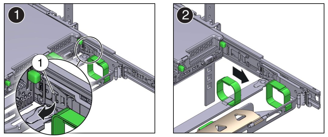

Disconnect connector D.
Press the green release tab (callout 1) on the slide rail latching
bracket toward the left and slide the connector D out of the left
slide rail (1 and 2).
When you slide connector D out of the left slide rail, the slide
rail latching bracket portion of the connector remains in place. You
will disconnect the connector in the next step.

1
Connector D release tab (green)
2
Slide rail latching bracket release tab
(labeled PUSH)
