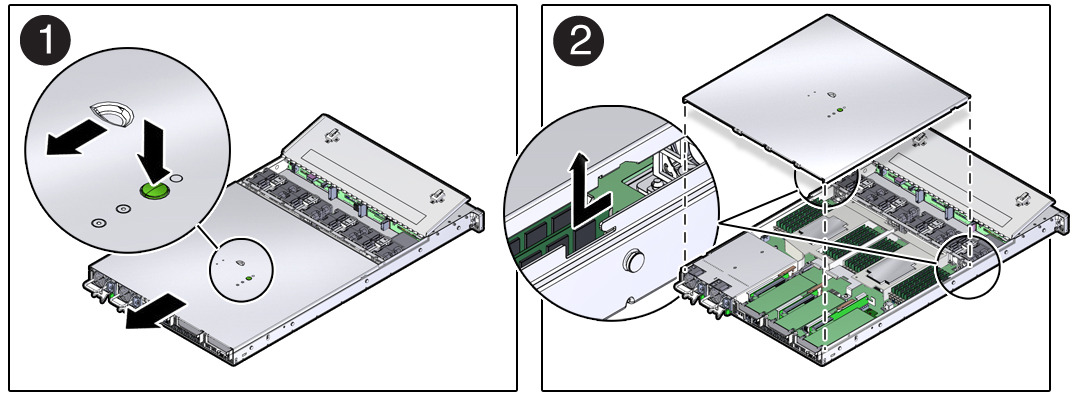

To open the server top cover, press and hold down the top cover release
button and use the recessed area to slide the top cover toward the rear of
the server about 0.5 inches (12.7 mm) (1).
Lift the cover off the chassis and set it aside (2).
