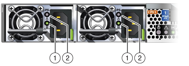

Each power supply contains two status indicators (LEDs) on the back panel. This figure
and table provide a description of the power supply status indicators.
1
AC OK/DC OK
Green
Off – No AC power
is present.
Slow blink –
Normal operating. Input power is within specification. DC
output voltage is not enabled.
Steady on –
Normal operation. Input AC power and DC output voltage are
2
Service Required
Amber
Off – Normal
operation; no service required.
Steady on– The
power supply (PS) has detected a PS fan failure, PS
overtemperature, PS over current, or PS over/under
voltage.
