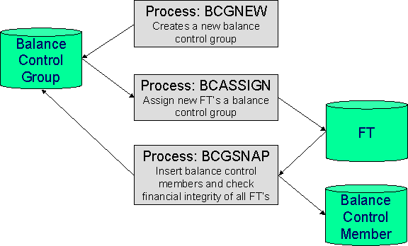

The Balance Control Background Processes
The following diagram illustrates the balance control background processes:
Contents
BCGNEW - Create A New Balance Control Group
BCASSIGN - Assign New Financial Transactions A Balance Control Group
BCGSNAP - Insert BC Members And Check Financial Integrity Of All FTs
Consider A Backup At This Point
This process creates a Pending balance control group if one doesn't already exist.  You may wonder why an entire process is dedicated to such a trivial task.  The reason is because the next process, BCASSIGN, is a multi-threaded (i.e., parallel) process and we only need one Pending balance control group regardless of the number of threads used to assign balance control ID's to financial transactions.
This multi-threaded (i.e., parallel) process assigns the Pending balance control group to new FTs whose freeze date/time is before the create date/time of the balance control record.
This process performs the following two functions:
·         It summarizes new financial transactions under the current Pending balance control group as follows:
·         It creates a balance control member for every combination of division, obligation type and FT Type referenced on the financial transactions belonging to the balance control group.
·         It updates each balance control member with the following information:
·         The number of financial transactions (FTs)
·         The sum of the total amounts on the FTs in this balance control group.
·         The sum of the current amounts on the FTs in this balance control group.
·         The sum of the total amounts from all FTs (in this and all other balance control groups).
·         The sum of the current amounts from all FTs (in this and all other balance control groups).
·         It sets the status of the balance control group to Complete.

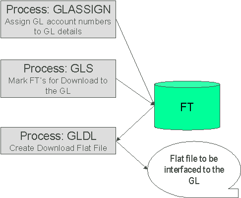

The GL Interface
The following diagram illustrates the GL Interface.
Contents
GLASSIGN - Assign GL Account Numbers To GL Details
GLS - Prepare FTs for Download
GLDL - Create General Ledger Download Flat File
The GLASSIGN process assigns GL account numbers to the GL details associated with financial transactions.  GL account numbers are assigned as follows:
·         Every GL detail references a distribution code.
·         Every distribution code references a GL assignment algorithm.  The base package algorithm simply uses the default GL account associated with the distribution code.  However, you can construct your own algorithm(s) to assemble your GL account numbers in your desired fashion.  Refer to Setting Up Distribution Codes for more information about the GL format algorithm.
·         The GLASSIGN process simply calls each GL's details distribution code's GL assignment algorithm and updates the GL detail with the result (i.e., the GL account number).  This GL account number is then used by the GLDL process when it creates the consolidated journal entry that's interfaced to the GL.
If incorrect GL account numbers get assigned to GL details...  If you do not plug in the correct algorithm or your algorithm is wrong, you can correct the GL account numbers that are assigned to the GL details.  How?  Write a simple program that resets the GL account numbers on the erroneous GL details.  Then run GLASSIGNGLASSIGN will re-execute the distribution code GL assignment algorithm and refresh the account number accordingly.
The GLS process creates FT download staging records for all FTs that are ready to be posted to the GL (the FT download staging records are stored on the FT/Process table).  Each FT download staging record is marked with a batch process ID and run number.
·         The batch process ID is the process responsible for creating the flat file that contains the consolidated journal entry that is interfaced to your general ledger.  The batch process ID is defined on Installation Options – Financial.  The system comes with a single GL download program (GLDL - Create General Ledger Download Flat File).  The GL account numbers are provided by the GL account algorithms that are specified on the distribution codes.  Refer to Setting Up Distribution Codes for more information about the GL account algorithm.
·         The run number is the batch process ID's current run number.
This process also changes the status of the FT to distributed.  You may not change the FT's GL details after this time.
The GLDL process creates the flat file that contains the consolidated journal entry that is interfaced to your general ledger.  One header and multiple detail records are created as described below.  At the conclusion of the batch process, a validation is performed to compare debits against credits.  If they are not equal, the process terminates with an error.
