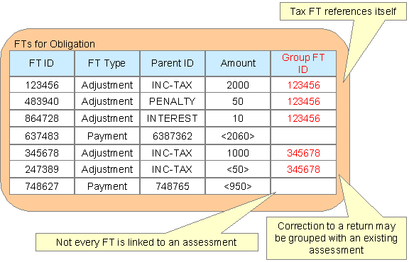

As financial transactions are created for an obligation, often they are related to a specific liability such as an assessment, which is also a financial transaction (associated with an adjustment or a bill segment). For example, a payment may be made for a specific assessment. Penalties, interest and fees are often levied toward a specific assessment. Associating these subsequent financial transactions with the appropriate assessment FT ensures accurate penalty and interest calculations and accurate views of the balance of each assessment associated with an obligation.
The system provides a means for your implementation to group financial transactions (via the Group FT ID). When creating a financial transaction that should be associated with a given assessment, set the group FT id to the FT Id of the assessment. The following example shows the usage of the Group FT Id field.
The original assessment FT (sometimes referred to as the "header FT") references its own FT id in the Group FT field. This allows system functionality to easily identify the assessment financial transaction.

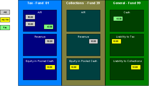

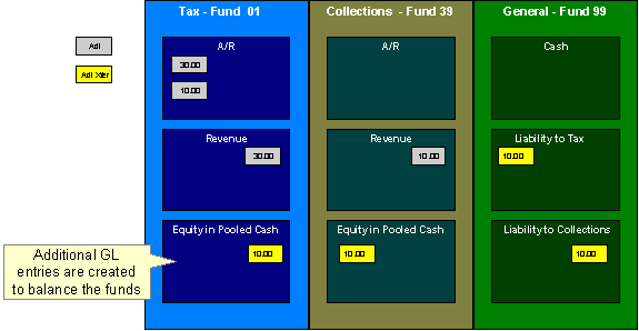

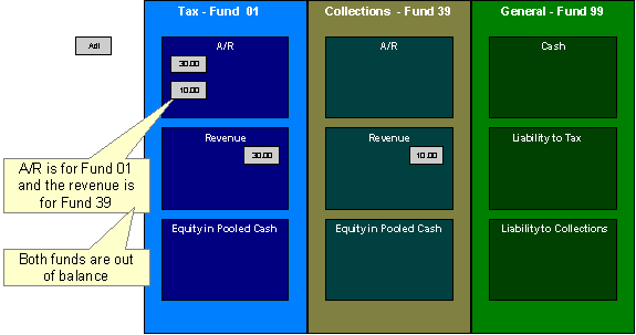

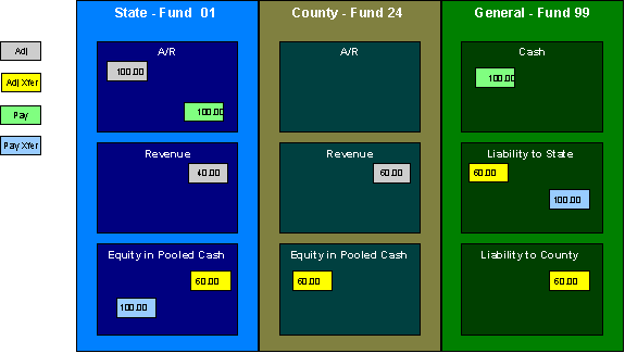

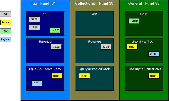

Most adjustments affect the general ledger (GL) in some way. The following points describe the source of these GL accounts.
· For many adjustments there is a single accounting entry generated:
· One side of the accounting entry is taken from the distribution code on the obligation type of the obligation affected by the adjustment. For example, if you are adjusting the payoff balance on a normal obligation, the A/R account is constructed from the distribution code on the obligation’s obligation type.
· The other side of the accounting entry is taken from the distribution code on the adjustment’s adjustment type.
· For transfer adjustments (i.e., adjustments used to transfer moneys between two obligations), there are two accounting entries generated - one for the “from” side and one for the “to” side. Each adjustment carries its own set of balanced GL accounting details.
· For each adjustment, one side of the entry is taken from the distribution code on the obligation type of the obligation affected by the adjustment
· The other sides of both accounting entries have the same GL account. This account should be the intermediate clearing GL account that is to be used for the transfer. The source of this clearing GL account is the distribution code on the adjustment type used to transfer the funds.
· For generated adjustments, the accounting entry may include several GL details:
· One side of the entry is taken from the distribution code on the obligation type of the obligation affected by the adjustment.
· The other side of the entry depends on configuration on the adjustment financial transaction algorithm. If it is configured to use the Calculation Lines as the source, the distribution codes are taken from the calculation lines. If it is configured to use the adjustment type as the distribution code source, the other side of the accounting entry is taken from the distribution code on the adjustment type.
Not all adjustments affect the GL. As a general rule of thumb, only those adjustments that affect an obligation’s payoff balance affect the GL.

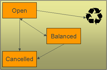

Match events are used to match open-items (i.e., debit and credit financial transactions) together. The topics in this section provide an overview of match events.
Contents
Match Events Match Debit FTs To Credit FTs
When Are Match Events Created?
How Are Match Events Cancelled?
Current Amount Is Matched, Not Payoff
For open-item taxpayers, the system matches credit financial transactions (FT’s) to debit FT’s under a match event. The following are important points about match events.
· A match event may contain an unlimited number of FT’s. For example, the match event can match 2 credit FTs against a single debit FT.
· A match event contains FTs associated with a single account. While the FTs under a match event may belong to multiple obligations, all FTs under a match event must belong to the same account.
· The status of the match event is balanced when the sum of the debits equals the sum of the credits. If debits do not equal credits, the status of the match event is open and the various FTs would still affect the taxpayer’s aged debt. Refer to Match Event Lifecycle for more information.

The following diagram shows the possible lifecycle of a match event:
Match events are initially created in the open state. Financial transactions (FT’s) linked to open match events affect arrears, but not in an open-item fashion. Rather, FT’s linked to open match events affect arrears in a balance-forward fashion. Refer to Open Item Versus Balance Forward Accounting for more information about these two accounting methods.
A user may delete an open match event. When an open match event is deleted, its FT’s may be linked to other match events.
The system automatically changes an open event’s status to balanced when the sum of the debit financial transactions (FT’s) equals the sum of the credit FT’s for each obligation on the match event. It’s worth stressing that a match event may contain FT’s from many obligation’s and each obligation’s FT’s must sum to zero before the match event can become balanced.
A user may reopen a balanced event (by adding / removing FT’s so that the match event becomes unbalanced).
A user may cancel a balanced or open match event. Refer to How Are Match Events Cancelled? for more information about cancellation.

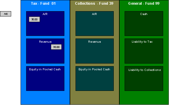

When a tax is levied, the following adjustments are made to the tax fund account producing the following GL entries.
For the tax fund, the GL details of the bill include a debit to the accounts receivable (A/R) account and credits to the revenue account. The taxing authority is owed the entire portion of the adjustment by the taxpayer. The tax fund is balanced.
The following diagram illustrates the initial GL accounting that occurs when a collection fee is levied.
Because A/R is added to the tax fund and the revenue is added to the collections fund, the funds are out of balance.

The following diagram illustrates the initial GL accounting that would occur when the payment arrives.
The tax authority's general cash account is debited, and the tax fund's A/R account is credited.
If the accounting were left in this state, the fund accounting principal – that each fund represents an independent entity with a self-balancing chart of accounts – would be violated. This violation is caused due to the fact that cash is recorded on the general fund, not the tax fund, causing the general fund to have an excess debit and the tax fund to have an excess credit.
From an organizational viewpoint, to make the tax fund whole, the tax fund needs to note what portion of the cash it owns, and correspondingly, the tax authority needs to note what portion of the cash is owed to each fund. The following diagram illustrates this point.
To maintain a balance of debits and credits within each fund, the tax and collection funds have an "equity in pooled cash" (EPC) account and the general fund has a liability account for each fund. In addition to debiting the general fund’s cash account and crediting the tax fund's A/R accounts, the tax and collection funds’ EPC accounts are debited and the general funds liability accounts are credited.
And so, with the additional GL entries, all funds have matching debits and credits.

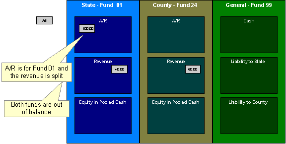

When a $100.00 tax is levied, the following diagram illustrates the initial GL entries for this scenario.
The state fund’s A/R is debited, and the state and county funds' revenue accounts are credited.
If left at this, the funds would be out of balance; the state fund would have an overall excess debit and the county fund would have an excess credit.

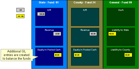

To balance the funds, the state fund accepts the responsibility for collecting the county taxes from the taxpayer but immediately remunerates the charges to the county fund.
This transfer is done using the general fund. The state fund’s EPC account is credited and the liability to state is debited with the amount of the county sales tax revenue. Also, the county fund’s EPC account is debited and the general fund’s liability to the county account is credited by the county sales tax revenue. In effect, the state fund owes the county charges to the general fund, and the general fund owes the county charges to the county fund.

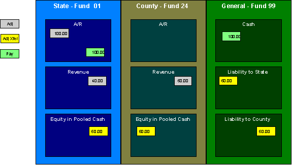

When the payment arrives, the cash is debited to the general fund’s cash account, and the state fund’s A/R is relieved. Again, the funds would be unbalanced if left in this condition; the state fund would have an excess of credits and the general fund would have an excess of debits.
To maintain each fund’s balance of debits and credits, the general fund’s liability to the state fund is credited by the amount of the fund’s share of the cash, and the state fund’s EPC is debited. Note that the payment has no effect on county fund’s EPC and the general fund’s liability to the county fund. The county fund "received" its money from the state department when the adjustment was created.
And so, all funds have matching debits and credits.
