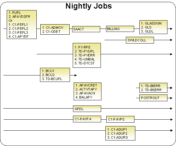

The Nightly Processes
The following diagram illustrates the dependencies between the batch processes.
The mnemonics in the boxes refer to the individual batch processes described above.  When a box contains multiple processes, these processes must be run sequentially.  When multiple boxes exist on a timeline, all processes in an earlier box must execute before the subsequent box is executed.  Those timelines that appear beneath the first job stream’s timeline indicate when the timeline’s respective processes can be executed in respect of the first job stream.
The following diagram illustrates the daily batch processes for which there are no dependencies.
No dependencies exist.  As you can see, there are no dependencies between the boxes (meaning they may be run in parallel).

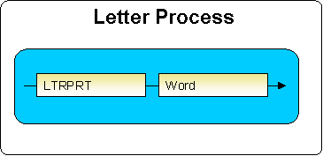

The Letter Processes
To extract information for your various letters, only one background process, LTRPRT, is required regardless of the different types of letters you have.  This process simply calls an algorithm plugged-in on the respective letter template to construct its flat-file content.
The following diagram illustrates the dependencies for the letter background process.  While this process should be run at least on a daily basis, you may want to consider running it more frequently (depending on how frequently you produce letters).

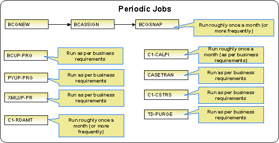

The following diagram illustrates the dependencies between the periodic background processes.  While many of these processes should be run at least on a monthly basis, you may want to consider running them more frequently (depending on business requirements).
Few dependencies exist.  As you can see, there are few dependencies between the boxes (meaning they may be run in parallel).

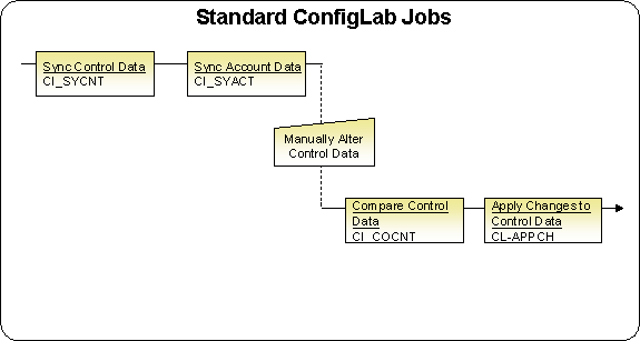

The ConfigLab Processes
The following diagram illustrates the dependencies between the ConfigLab processes.  The frequency of running ConfigLab processes is implementation specific.  For more information on comparing data from an alternate environment, refer to Configuration Lab.
Compare Sources and Targets.  The Configuration Lab may be used with environments other than a ConfigLab.  In cases where control and account data are pushed to a Compare Target, only the top two batch processes are executed.  In cases where control data is pulled from a Compare Source environment, only the bottom two batch processes are executed.

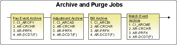

The Archive and Purge Processes
The following diagram illustrates the dependencies between the sample archive and purge processes.  The frequency of running archive and purge processes are implementation specific.  For more information on archive and purge processes, refer to Archiving and Purging and Archive Engine.
Steps 2, 3 and 4.  Note that steps 2 and 3 are the same for all of the sample archive and purge jobs.  For step 4, you can select from two background processes: AR-DCDT moves data to a target archive environment (or purges the data) and AR-DCDTF calls an algorithm that copies the data to a flat file.  If you want to use AR-DCDTF for other archive jobs, you must develop your own algorithms.
