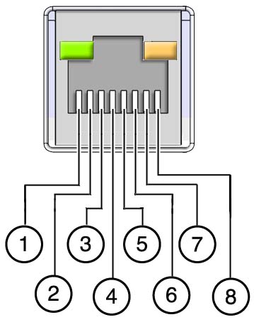

Network Management Connector and Pins
Illustration shows the network management connector pinout.
The following table lists the pinout of the network management connector.
Pin.
Signal
1
TXD+
2
TXD-
3
RXD+
4
Not used
5
Not used
6
RXD-
7
Not used
8
Not used
