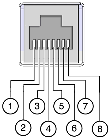

Serial Management Connector and Pins
Illustration shows the serial management connector pinout.
The following table lists the pinout of the serial management connector.
Pin
Signal
1
RTS
2
DTR
3
TXD
4
GND
5
GND
6
RXD
7
DSR
8
CTS
