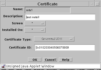

The Certificate dialog box appears.
Type a name for the new remote Administration Station in the Name field.
Type the certificate number of the new remote Administration Station in the Certificate ID field.
The Certificate ID begins with 0x.
Click the OK button.

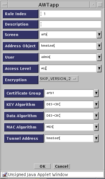

Click the Edit button below the Access Rules for Remote Administration table.
The Remote Access Rules dialog box appears. Note the name in the Certificate Group field. In the following steps, you must add the certificate of the new remote Administration Station to this group.
Click the Cancel button.
